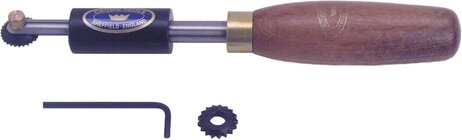

Found a you tube video that I wished I'd seen before I did this bottom. It would probably look different than it does now.
That's with the spiraling wheel, right? Does the tool also come with a star wheel with sharp points?
I just replaced the Sorby Micro spiraling/texturing tool that I gave away a few years go - it came with two sizes of spiraling wheels and one pointed texturing wheel. (I get more use out of the pointed wheels)
I have played some with spiraling wheels, seems like you only get one chance!
If I want spiral texturing on something like, say, a box lid, I feel safer cheating - texture a thin disk then glue it into a recess in the box lid!
Hey, do you know Frank Penta? You can't hang out with Frank without a texturing tool in your pocket - he's a hard-core texturing maniac. :)
