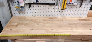

I have some hardboard, with the smooth front surface. It seems very flat to me. Thing is, I am not really sure how to test if it is indeed flat, or at least, flat enough. It appears flat, but there could well be a curvature or something to it that would mess up properly flattening the bottom of this plane. Just wondering if anyone has any tips there. At some point I'll probably be able to pick up an engineers block that is perfectly flat, but that won't happen for a while here. Hoping this hardboard will suffice. It certainly seems to have a very smooth, very flat surface.
One other question as well. Watching Paul Sellers, he has a block of metal that is exstremely flat. Within one thou he said. Someone earlier in this thread mentioned I didn't need to be that perfect, but...I do need a flat surface to sand the bottom of the plane with.
Can't help with vinegar smell in workbench, though probably a google search to neutralize vinegar (Acetic acid, so I hope your bench isn't glued up with PVA glue, which Vinegar will break the bonds - I've used vinegar to take apart glued-up joints....)
As for hardboard, depends on how thick it is - if it is like 1/4 inch hardboard, it'll simply flex on uneven surfaces. Perhaps stop by your local building supply and see if they have any scrap countertops (Melamine, perhaps or Marble - They often may have offcuts from cutting things to size, or scrap melamine which is often used as cover sheets on truckload shipments...) If your hardboard is like 3/4" thick it should probably be flat enough.
As I mentioned, plane soles don't need to be 100% perfectly flat, you just need flatness in the area of the toe to the front edge of the mouth , and then mostly back to the heel and along the sides - If you have unpolished spots (under the frog for example) it isn't so much a problem. Also, when flattening your plane, make sure it is fully assembled with blade and chip breaker and everything installed (just back off the blade so it doesn't stick out) Because the plane body can flex once you fasten down your lever cap , so if you flatten the plane sole without everything assembled, then when you go put it together, your sole is no longer quite flat.
@Brian Gustin Its funny. I've been doing searches for how to clean up white vinegar. But, all I get back from various search engines, is how to clean WITH white vinegar. :p I've become completely disillusioned with search engines these days. They are useless. Maybe Claude will have a better answer...
I don't know if the workbench is glued with PVA or not. I bought it from Harbour Freight. I have several of them, actually, and they were around $120-130 each. Not top of the line, but, they were actually pretty nice overall, and the finish was good, the tops were very flat.
Good thought about countertop cutoffs. I might try that. That's a great idea.
Also thanks for the tip about having it fully assembled. I hadn't thought of that. I guess that's how Paul Sellers did it, but I did not think about the flex. I'll make sure its assembled when I flatten the base. Thanks!

Q: The surface of the workbench seems to have warped a bit. Should it be planed flat with a hand plane first?​
Yes - if the surface has warped, it's best to address the flatness issue before refinishing. However, before planing, let's make absolutely sure the wood is completely dry to avoid further movement. Since the vinegar can penetrate pretty deep:
1. Wait at least 48 hours after the baking soda treatment for thorough drying. You can aid the drying by:

2. Once dry, approach the planing carefully:
- First, check the direction of the grain
- Start with a light cut on your hand plane
- Work diagonally across the warped area first (around 45 degrees to the grain) to quickly remove high spots
- Then switch to planing with the grain for the final passes
- Keep checking for flat with a straightedge from multiple angles
- Be careful not to take off more material than necessary
- Plane a bit beyond the affected area to ensure a smooth transition
After planing, then proceed with the sanding and refinishing steps I mentioned before.

I intended to plane regardless. Just wanted to see what Claude would say. Not sure if I would just sand it. Its too uneven now, and I would be afraid sanding would result in a less than optimal surface. But a longer hand plane I think, should level out the warps nicely.
I'd play wait and see - first try and do any neutralizing (water & baking soda mix perhaps) and then give it several days (or a week or two) , might also help to apply some heat to the warped areas of the benchtop (what kind of wood is it anyway? I'd have thought Harbor Freight would have been using MDF or HDF plus laminate - cheap stuff.... unless it is bamboo..)
Wood moves with moisture gain / loss, so if it is allowed to dry completely (assuming it isn't MDF or HDF particleboard) it could easily return to nearly flat & even. However if it was a MDF or HDF particleboard top, then it's pretty much screwed any way you slice it... (I'd as soon go to the building supply store and enough 2x4's when laid side-up to make a benchtop, which is what my workbench is built of...) I can't imagine being concerned with the finish of a workbench top, if it is intended to be used for , well, work..... eventually it is gonna get dings, dents, chips, what have you... my only concern with mine is keeping it flat, and with 3-1/2 inches of thickness, I got TONS or room to plane it down every now and then before I start to hit the construction screws used to hold the boards together (with construction adhesive in between) a #5 jack or #6 fore plane probably would be sufficient for flattening.
I don't think it was actually a harbor freight brand. It was Taiwanese, or Chinese. Its actually fairly well built. Only 1" thick, but the wood is nice, its well constructed, sturdy, nice drawers. I have three of these now, I think each one was branded differently, but hey are all the same thing.
I've cleaned it with water and baking soda. It did not sizzle or fizzle, it actually looked like the water vanished pretty much instantly, so it probably soaked into the wood. It dried of pretty quickly though. They are nice work benches, for the price. I've seen similar workbenches listed for $1200-$1800 or more. They are thicker on the benchtop, similar in design (but probably more sturdy, the legs and cross braces are usually bigger.) Most only have one row of drawers, or with some of the more expensive ones they have full cabinets. When I bought these, first one was late 2020, then a couple more at different times in 2021, I was very new to woodworking, and only did turning and nothing else. As I get into other things, though, the benchtop becomes more important. I think each of these were $120 or $130 each. So I think I spent less than $400 total on all three. For a beginner woodworker, its a pretty darn good price. ;)
Regarding flattening the plane sole, thicker plate glass scrap from a glass shop (at least 3/8" thick, preferrably 1/2"), and about twice as long, or so, as your plane, will provide a surface flat enough for the purpose. As well, with the popularity of stone kitchen countertops (at least in my area), it's easy to find stone countertop fab shops who have tons of scrap, often free (or cheap if they're really money grubbers) for the asking. I stopped at a local fab shop and he showed me the pallet of scraps that are refuse. Several kitchen sink cutouts, so around 30'ish x 18'ish inches. Heavy. Sharp edges that should be mellowed at home (same with glass). And for any woodworker's purposes, plenty flat. Stick a 3" wide strip of J-weight cloth 60-grit sandpaper to it, and you'll flatten the bottom. Follow up with 100 and 150 or so grits, and also relieve sharp edges on the plane bed that may develop. I also keep my shop vac with brush head handy, to clean the surface of the sandpaper as I'm working.
Years from now, when I can build my larger retirement workshop, I'll build a dedicated bench with one of these stone scraps as the top. It also works great as a flat surface reference for building flat board projects, like checking glued-up boxes for wobbling on 2 corners, so I know where to plane the high spots off.
Paul Sellers has his "oil rag in a can" trick for oiling plane soles, saw blades, etc., or a swipe of paraffin wax from a canning wax block (grocery store), these will help those tools glide along the wood in use.
Having a true flat surface for making the bottoms of your planes dead flat is necessary. If you have a table saw, that is one that is pretty much dead flat. I did buy a granite block specifically for doing this, but most of the time I use my table saw.
I think all work benches start out pretty close to flat. Depending on how thick they are, they will move. Any over about 2 inches thick will move because the internal wood never comes to equilibrium with the "outside" air.
I do have a table saw. I'll give that a try. Picked up some more white vinegar and am soaking the other parts here. Should be able to work on flattening by this evening.
