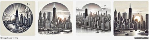

I've been using Microsoft/Bing Image Creator to generate AI art for about a year, then mod and clean up the image using Lightburn. Here's an example of the AI output from these prompts: "Chicago skyline, beautiful sunset in background, black and white, detailed line drawing, no gradients, centered, well-balanced, negative space"
And here's the finished product. Maker's mark in lower righthand corner added with Lightburn, along with other clean-ups and tracing for 10w diode lasering:

All of them are about the same, but Microsoft's image generator is pretty good. You can find it at https://designer.microsoft.com/ Under the "Create with AI" menu you can pick what types of images you want to generate.
