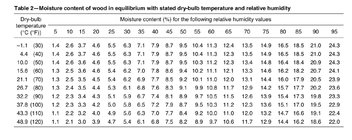

The ability to KNOW what the humidity and temp. in your workspace are very helpful in choosing how you want to dry wood...
For air drying wood you have to know the temperature and humidity of the drying area to know what the moisture content you can achieve. My drying area is 50% humidify average temp 70F. My wood will dry to about 9%.
The forestry service chart below will tell you what MC dry is in you drying area

The above is nice for when you are drying planks, but doesn't help with the slowing down of drying bowls, to prevent the splitting of these pieces.
Like I said the bowls in a brown paper bag are in an artificial created environment, where homes and shops are normally not experiencing the extremes and much more suited to the humans that inhabit these places :)
The only thing that is affected by drier and warmer/cooler homes/shops is the drying of the paper bag, placed in a spot without fans or wind (like heating/cooling ducts) blowing over it, the drying is not that much affected by these small differences in peoples created environments.
This is my experience from the last 40 years, as I say, it works.
8,653
5,017
I use bags too. Totally different part of drying. Final couple of months I take the bowls out of the bag.
The equilibrium MC in my drying room will be around 9%. Since that environment is similar to most homes the bowls will be fine.
If I were to dry bowls in my shop or a shed Equilibrium MC will be over 12%. I prefer 9% before returning.
For once turned bowls not so important as the warp is part of the piece.
