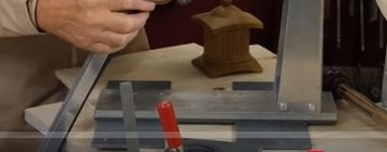

Router fluting jigs need a large base so they don't tip in usage. The one linked to in post #46 has too small a base. It has holes in the base that I assume are to screw it to large base.
In Paul Howard’s original instructions for his jig (he no longer sells them himself) there was mention of fitting it to a larger base if required.
My home made jig is pretty much the same size as the PH jig and I’ve never experienced any tendency for it to tip as you suggest.
A guy called William Hunt has produced a series of videos of the PH jig in use and I don’t recall him using a larger base?
Before making my jig I did look on the net for inspiration from other users and once again I don’t remember seeing any jigs with what I might term a large base. I’d be interested in seeing one though if you have a kink Doug as I may be missing something?
I should add that Paul Howard mentions using a PVC plate on the bottom of his jig. It is though the same size as the alloy base.
This snip from the video in the first few seconds clearly shows the wider base he is using. I think he may have even mentioned the wider base in the video.

I've made jigs of this type for use on wood shapers. For the shaper application you're dealing with much greater cutting forces so you need a wide base and heavy mass in the jig. The shaper jigs have been 20 pounds and more. With a smooth, weighted, wide base sliding on a smooth surface the weight is irrelevant.

That’s the first time I’ve seen a wide base like that used. I’ve cut many pieces with my jig and it’s only 100mm wide.
Provided the cutter doesn’t overhang the base which is also free to slide I don’t see the problem you’re experiencing.
