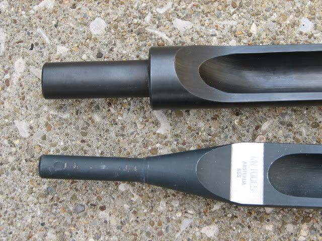

There should be more than steel alone. No doubt better steel provides more wear resistance, more turning and less sharpening. But an inferior shaped flute would cause clogging or chattering.
When I examined the flutes, I noticed the slight difference, but never thought the difference would be so dramatic. May be all the gouges are sharpened to an angle which is deceiving.
I made a wax mold of each flute; I then used a hand plane to get rid of the overfill. I scanned them on the flat bed scanner and enlarged them 200%. I was surprised that the scanned images have a 3-D effect.
We are all taking about "U" and "V" flutes. But from the pictures, there are variation in flute depth and it is hard to define "U" and "V". Some are hybrids.
If you look at the 1/2" and 5/8" (I am using American Standard here) Crown Pro-PM, the 1/2" is definitely one of the tightest "V" flute gouge, but the 5/8" is one of wider "U".
I don't think I am qualified to give expert opinion that which is better than which. One of the major complaint about the Glaser tool is the "V" flute tends to clog. On the other extreme is a spindle gouge which is the most open flute gouge. We don't want to use it for side grain bowl turning, so there must be a happy medium in the middle.
I want to do my part and provide some raw pictures of flute cross sections. There are more than difference in steel. I believe with the difference in flute, we can't get the same grind even with identical grinding jig settings.
I borrow the 5/8" V gouge from Doug Thompson to do this project. What I had was an early production of the Thompson gouge, I knew he has made some changes in flute design. He has made the flute more open and decreased the depth of the flute. Since mine is no longer available, it would be better to do on the current production.
All my other gouges are more than 2 years old, they may not reflect the current gouges.
After I have done that, I think I should have included the Thompson "U" gouge, I borrowed one from Doug at today's slub meeting. I am going to post the casting when I am done.
Due to the photo size upload limitation on this Forum, it is difficult to see the details. I have posted larger pictures here:

Gouges
The two gouges shown in the photo are P & N (Patience & Nichols, I think) from New Zealand or Australia.
Excellent tools. but they are SPINDLE roughing gouges!
They are not bowl tools!
If you want a bowl roughing gouge try one of Thompson's or Crown's 1" bowl gouges. I have 2 Crown 1" bowl gouges. Each are ground differently for different purposes. One has a fingernail grind......well more accuratley a thumbnail shape and the other with a nearly out of the box square end grind. excellent for roughing out stock or taking that last sweeping cut with a long overhang on the tool rest. They have a 1 " dia tang that goes into the handle. This is a safe tool to rough bowl blanks.
It is dangerous to use a SPINDLE roughing gouge to rough a bowl blank.
See the Article in American Woodturner by Alan Lacer.
A
The bottom tool in the picture is a P&N but the top is how I think a shank on a SPINDLE roughing gouge should be... a full 3/4 inches. The P&N is a very good tool, with the 1/2 shank it's stronger than a flat tang. Like Angelo just said DO NOT use a spindle roughing gouge on a bowl! They will break!
Flute shape does matter, the most basic shape is the SRG. It works well because of the large radius that can be rolled to change the cutting angle. This is the same flute which is also used on our spindle and detail gouges. If I made the flute deeper on a U shape bowl gouge it would turn into a SRG. That's just one example, other flute shapes have a place on the tool rack for different reasons.
Who ever said a scraper had to be made from flat stock, a scraper made from round stock works very well inside a bowl. There are many ideas that need to be tested but basic shapes seem to work the best.

I took that picture.
The top one is the Thompson SRG, it has a 3/4" shank, it is made out of A-11 steel.
The bottom one is the 1¼" P&N SRG, the shank is reduced to 1/2". I don't understand why it has to be reduced that much.
As far as I know, these are the only SRG that have round shanks instead of tiny flat tangs.
A good tool has to be well designed in addition to having good steel.
Gordon
