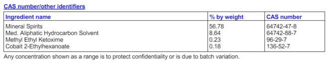

hughie, you're not the only one having trouble getting Antique Oil. It looks like Minwax has stopped making it. See the responses from Minwax customer service in the Q+A section here: https://www.minwax.com/en/products/...l-finish#accordion-69cbedd7e3-item-43c478dde5
Minwax's technical data sheet gives some clues to the composition, but no specific details. "Antique Oil Finish is a clear, light amber, low viscosity liquid made from a balanced blend of linseed oil, varnish, and other premium oils. It is designed to be hand-rubbed into wood to enhance the grain and provide a durable protective finish." https://paintdocs.com/docs/webPDF.j...TION:,a volatile petroleum distillate solvent.
Safety data sheets list the potentially dangerous ingredients:
Good luck. I hope you find a suitable substitute.
Minwax's technical data sheet gives some clues to the composition, but no specific details. "Antique Oil Finish is a clear, light amber, low viscosity liquid made from a balanced blend of linseed oil, varnish, and other premium oils. It is designed to be hand-rubbed into wood to enhance the grain and provide a durable protective finish." https://paintdocs.com/docs/webPDF.jsp?SITEID=MINWAX&lang=2&doctype=PDS&prodno=027426670006#:~:text=COMPOSITION:,a volatile petroleum distillate solvent.
