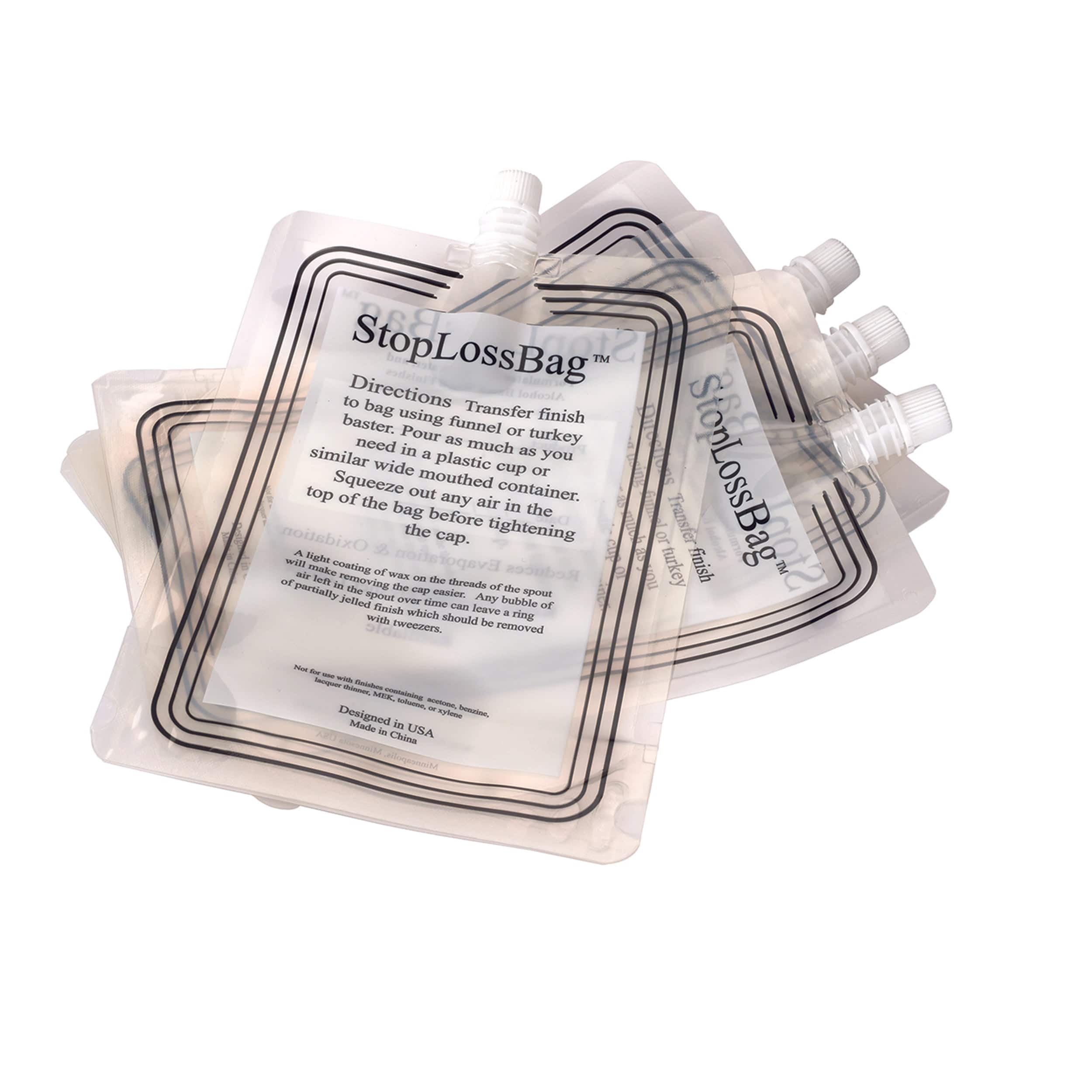

Most of these finishes have limited shelf life if stored in the presence of air, specifically oxygen. In other words, the finishes will start to degrade as soon as they are opened. Some like Waterlox are notorious for very short shelf life. Many others will continue to work, but may take longer to cure, or not wet out on the surface of the bowl as well as when they were new.
Stop Loss bags solve that problem and keep finishes fresh for long times, > 3 years in some cases for me. You might consider using them as you acquire finishes to test.
This is super helpful thank you!

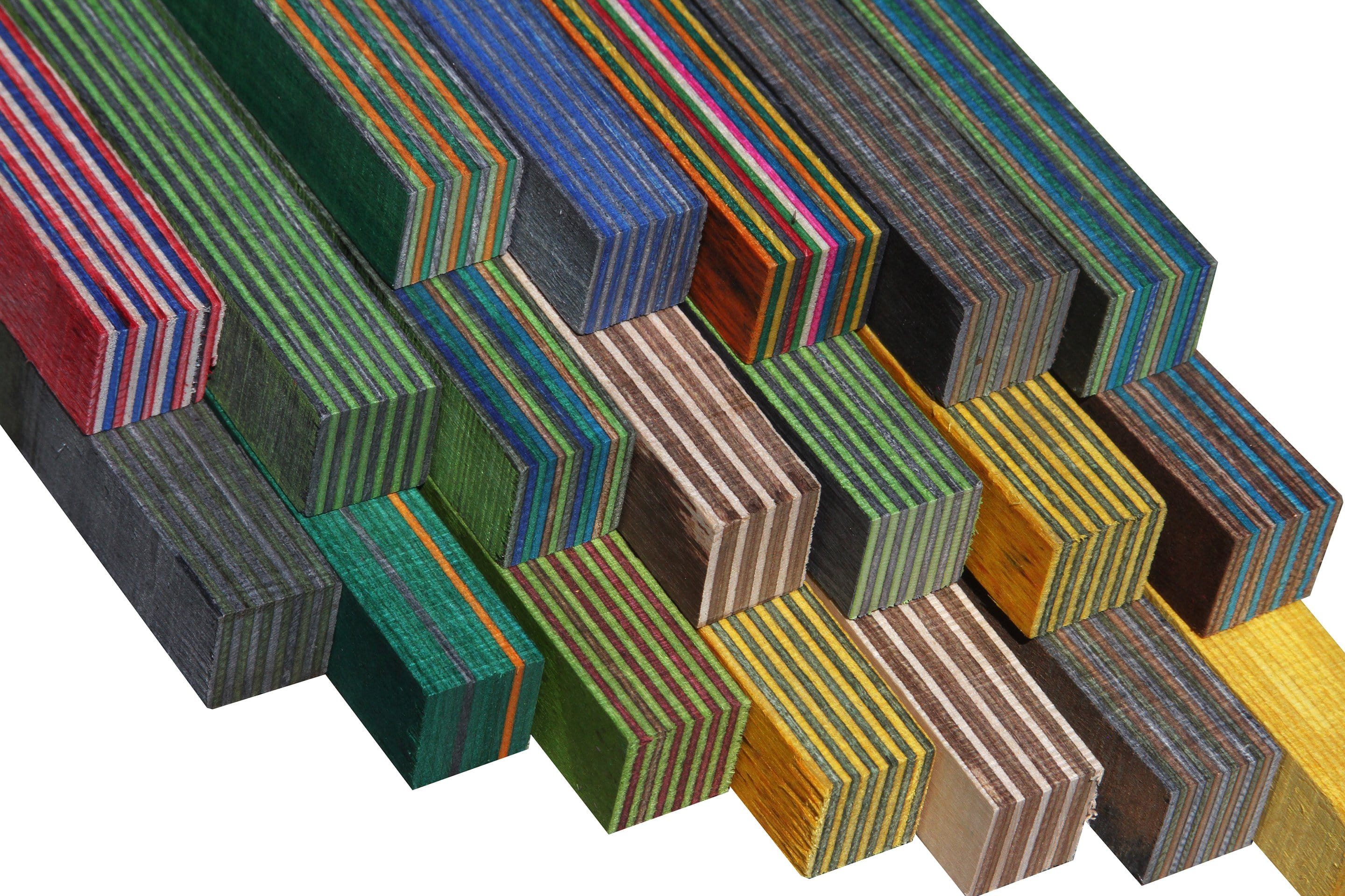

(But sometimes I cheat and turn from SpectraPly! Shhh, don't tell anyone...)

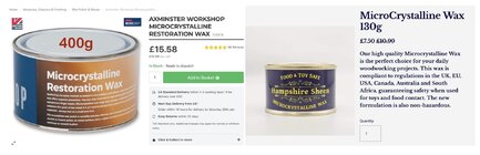

How does Axminster wax compare to hampshire sheen?

Interesting, here in the States they're very similarly priced and that's before shipping. I didn't even look at shipping.
Nope Charlie!
When researching the prices, I was looking at what I paid for my tin and comparing the current price of Axminster with that. Axminster is definitely cheaper than Hampshire Sheen. I'll have to check it out when I need more. BIll, thanks for the insight!
