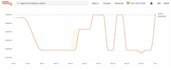

Thanks for sharing the suggestions, Paul. I was talking to a friend who is in hospital procurement about used options. She suggested to be sure the kit comes with a battery charger. Evidently, hospitals can buy the respirators without chargers since they are used so frequently.
The pricing is all over the place. I took a look on Amazon and see what you mean by being patient.
