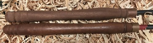

In the spirit of similar threads which focus on other aspects of our shops and working setups, here's a thread to show off the handles you've made. A lot of the work shown here are our "gallery pieces", wherever they actually end up. But sometimes good turnings – our shop tools, kitchen utensils, and so on – go unsung. I'd love to hear a little about your favorites, perhaps why you like it, what makes it work well, or anything else you'd like to share. Form AND function are all fair game!
I'll go first. The larger handle in the first photo is the first handle I made, using an Alan Lacer burnisher kit. The smaller tool is a small-diameter burnisher I made later, using an inverted Dremel carbide cutter bit I received from Eric Lofstrom at a workshop. (To install, you just screw the bit into the handle!)
Here's my most recent addition, just a few days old. I've been putting a lot of time into learning skew work in recent months, and wanted to dial in the handle. I've come to realize that my prior skew handle was just too heavy. The collet tool holder is from Robust, the wood is bubinga finished with Hassui Ceramic. I added the custom brass ferrule, cut from brass tube, cleaned up on the lathe using a three-jaw chuck, and sealed with Everbrite's ProtectaClear.

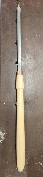

I mostly use the handles that come on the tools. Most of the time, if I'm making a temporary or one-use tool, I'll just grab a handle from that drawer of ancient garage-sale tools I picked up ages ago.
But I do make handles, mostly for home made "keeper" tools - here's a few:
Top to bottom:
A small pointy scraper (point tool maybe) made from an "aircraft" style drill bit. Cherry, copper pipe ferrule.
A small 1/4" tenon sizer tool - sharpened one side of a wrench, scrapes a tenon and measures it at the same time. Cherry, copper pipe ferrule. Cut off the other end of the wrench and epoxied it into the handle.
A jacobs chuck for hand drilling. Found a bolt that fit the threads in an old chuck, epoxied that into the handle. Handle is probably walnut.
The 3/8" bit I use for depth-drilling hollow forms. Ash, I think. Bit is epoxied in. I like the large handle for grip. The o-ring on the drill is a depth gauge.

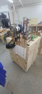

Hi, I'm new to wood turning and this group. Thank you all for sharing your various pictures, as they give me a glimpse of your shops, tools, organization and preferences. As I turn, I think back on those images for inspiration!
Welcome Duane! I've also gotten a lot of inspiration from these threads, which is definitely what prompted me to start this one. And my heartfelt thanks to everyone who's participated in this thread!
There are a few of these "show us your shop" threads floating around. We probably need a pinned index thread for them all at this point.
