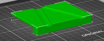

I have a 1/2" oval skew that doesn't set flat on the platform. I've always had trouble keeping the top and bottom angles parallel, often wasting steel in the process.
A couple weeks ago I 3d printed this fixture. The skew sets properly indexed. Now it's simple and accurate to touch up the grind.
