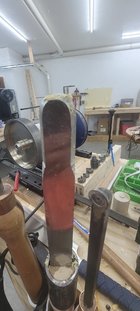

I’m using a thick Aluminum ferrule. I’m attaching pictures.
Then I’m going to use a couple of set screw for holding the tool and I’m going to use M4 tap or maybe is better to use and inset I have also M5 insets and set screws.
Nice week.
5,497
2,858
That looks fine. Some businesses will use the very thin brass ferules and then use a set 'divot' in them to hold them in place when the wood dries out. I think every single one of those I have has cracked off of that divot. I do like things overbuilt rather than underbuilt.... Too many years of concrete construction.... I didn't like my forms falling apart during a pour....

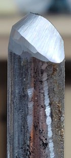

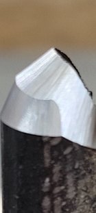

55 degrees and the just remove the bottom half of the bevel.
Thanks, I’m just going to sharpen my 3/8 Glenn Lucas spindle gouge for first time and I see that it also has two bevels and I I have a doubt do I only need to sharpen the bevel in the tip of the gouge or its a must to sharpen both angles every time you go to the grinder?
greetings

Probably only need to remove the heal every 2 or 3 sharpenings. Just eyeball it as anything less than full bevel is good but about 1/2 to 1/4" is usually best.

You need to sharpen it for the angle you want then remove the bottom of the bevel. I only have to remove the bottom of the bevel around every third sharpening.
