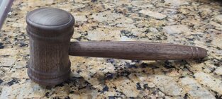

I do prototypes if it's a form I've not made before. Here's a prototype of a judge's gavel I did a year or so ago. I intended to make a couple of these for lawyer relatives but I never got back to it.
I like the gavel design! I'm glad you posted that - reminds me that I told our lawyer I'd make a sounding block for her. Yikes, that was 6 months ago...
I’ve made several. One tip if you haven’t thought of it: I once read of a gavel where the glue joint loosened with use. I started making them with threaded joints, glued. A bunch of years ago I found the wood tap and die sets for cheap at Woodcraft - I suspect they are available elsewhere too.
The 1/2" thread seems to be the right size for the gavels I make.
I started making them with pieces cut from the same chunk of wood to get the best match.
