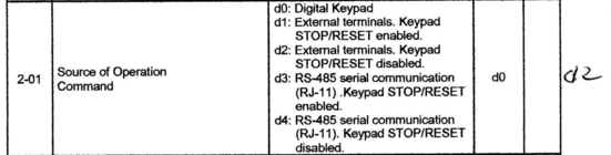

This is for the inverter as used on the Jet 1642. It will likely be the same or very similar to yours.
These two memory locations need to be set (to d1 and d2 respectably) as noted to the side.
This will switch control from the inverter panel to the front lathe controls.
Your electrician must not have any experience with these types of inverters / programming. You should not have to pay for his education.
