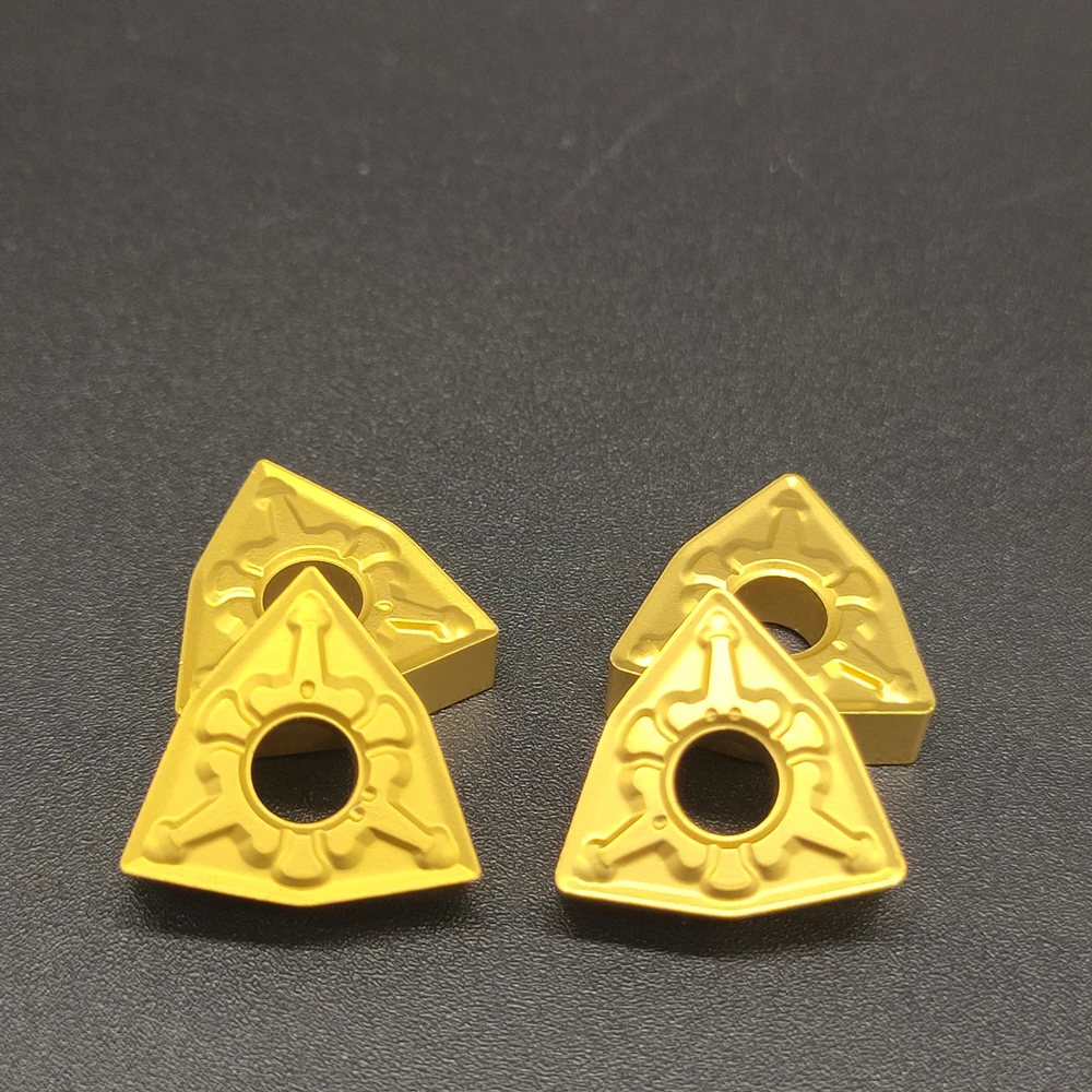

A slightly wider cutter when coring really large bowls off center would create better clearance and reduce the need to make multiple passes to widen the kerf. Since a wider Korpro cutter isn’t an option then I’d go with Robo’s suggestion of widening the kerf over the shim.
I‘ve been thinking about using CAD program to design a tip holders to test different size triangular shaped cutters like the ones below, but first I need to make friends with a woodturner who owns a CNC machine because many one-off CNC runs can get costly.
WNMG080404-WNMG080408-TM-T9125-carbide-inserts-External-Turning-tool-WNMG-080408-Lathe-Tools-of-machine-industrial.jpg_.webp
