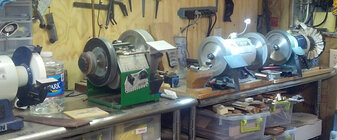

On the subject of lights, I just found this old photo, comparing two (of four) lights I use at my sharpening station. I aimed both lights at the wall behind the grinders.
A Ken Rizza's Super Nova light is on the left.
A multi-LED "sewing machine" light from Woodturners Wonders is on the right. (the SN head is in the shadows on the far left)
I use it with one bench grinder. (you might be able to see the head - the flexible "neck" is bent to extend the light vertically to aim it at the wall)
This shows that light in use over the second grinder from the right.
It certainly works but no comparison to the bright SN light (turned off in this photo).

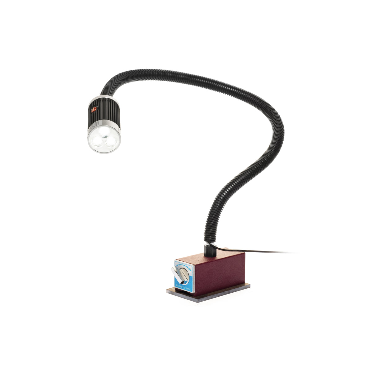

I already have one of the wood turners wonders magnetic lights but have trouble with it falling off the lathe cause the magnet is not strong enough.

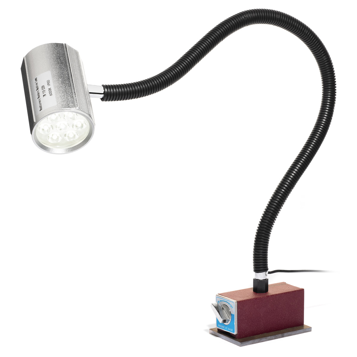

Curious, which light? I have a number of the Supernova lights and the magnets are quite strong anywhere I mount them. I can't budge them without turning the magnet switch to off. The Beacon lamp magnets are smaller but still feel strong. The tiny sewing machine lamps are not useful to me.
It the attachment point flat solid steel or cast iron? Might not work well on sheet metal or a curved headstock.
In a couple of cases I mounted the magnet on the wood wall behind the equipment: cut a steel plate a little longer and wider than the magnet base, drill and countersink holes, and fasten it to the wall with wood screws. I think the steel plate is maybe 3/16" thick.
A steel plate also works well on the wood workbench even if not fastened down with screws. Here I use one with a WTW Supernova lamp. The steel is a little longer and thicker than what I fasten to a wall.

Looks like their Aurora. Unless they've changed something it's magnetic base is smaller and less powerful than than the SN.
I'm thinking of unscrewing it from the base and kinda doing what you did only into a piece of wood instead of the lathe.
For those of us without a lot of metal working equipment (or time, or hate hacksawing) WTWs sells Lamp Anchor Plates. I see they are $3 more now than when I bought three of them several years ago. Lamp Anchor Plates

Check out our full line of lamps and don't overlook the Eclipse, which goes right on the tool rest and looks into the bowl. For Powermatic and larger lathes, I suggest the Quasar or Auroa because the flex neck goes into the side of the lamp head at 90 degrees, making it a choice for a headstock mount because of the graceful arc into the bowl. Super Novas and Beacon lamp heads are parallel to the flex pipe so tail stock side works better for me. By the way, I am still consulting for Woodturners Wonders, still work on new tool inventions, and still do the symposiums. You can reach me at ken.rizza@ woodturnerswonders.com for questions or issues and I will do my best to help you out- thanks. Ken
I decided to try this for while. I had an old jointer fence from a replacement that I had kept. Rigged it up behind my lathe and now the magnetic base is holding pretty good and it is completely out of the was when turning but still provides the spot light for inside of bowls and boxes.
That looks good but did you know Woodturners Wonders sells an Anchor Plate? Its a heavy medal rectangle about the size of our big lamp magnets with two recessed screw holes. In my old house I actuall put one of those on a low hanging wood rack I had mounted to the floor rafters and hung a Super Nova upside down.
