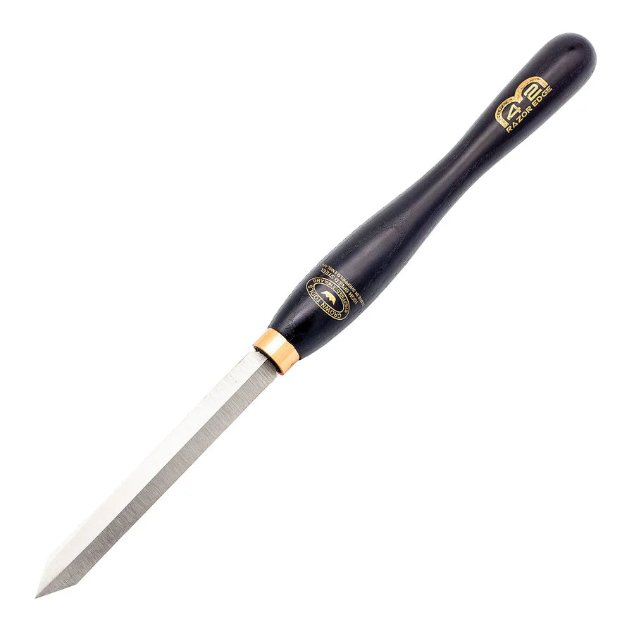

Speaking of Crown's M42 Razor Edge line, no M42 steel tools are listed at the Crown USA site, nor Crown's mothership site in the UK. I've not heard that they stopped production of them. Maybe, as they've been for 20-some years, their M2 and Pro-PM tools sell better. Comparing the characteristics of M42 steel (newer to them) to their established Pro-PM line, it was probably splitting hairs. I've emailed Crown UK asking about the M42, I'll report back if I hear anything. In the meantime, if you are interested in the Crown 2319RAZ Forged 3/4" Spindle Gouge (aka "continental gouge"), or any other M42 tools of theirs, you better look around now and take what you can get.

I received this message from Crown Tool overnight concerning M42 tools, good news-
HI,
We are still manufacturing these (M42 turning tools). Our new website will be launched in less than 6 weeks so you will see them there.
They are available from
Lee Valley
Rockler
Woodcraft
Hartville Hardware
(And other retailers, such as shown by Bill above.)
