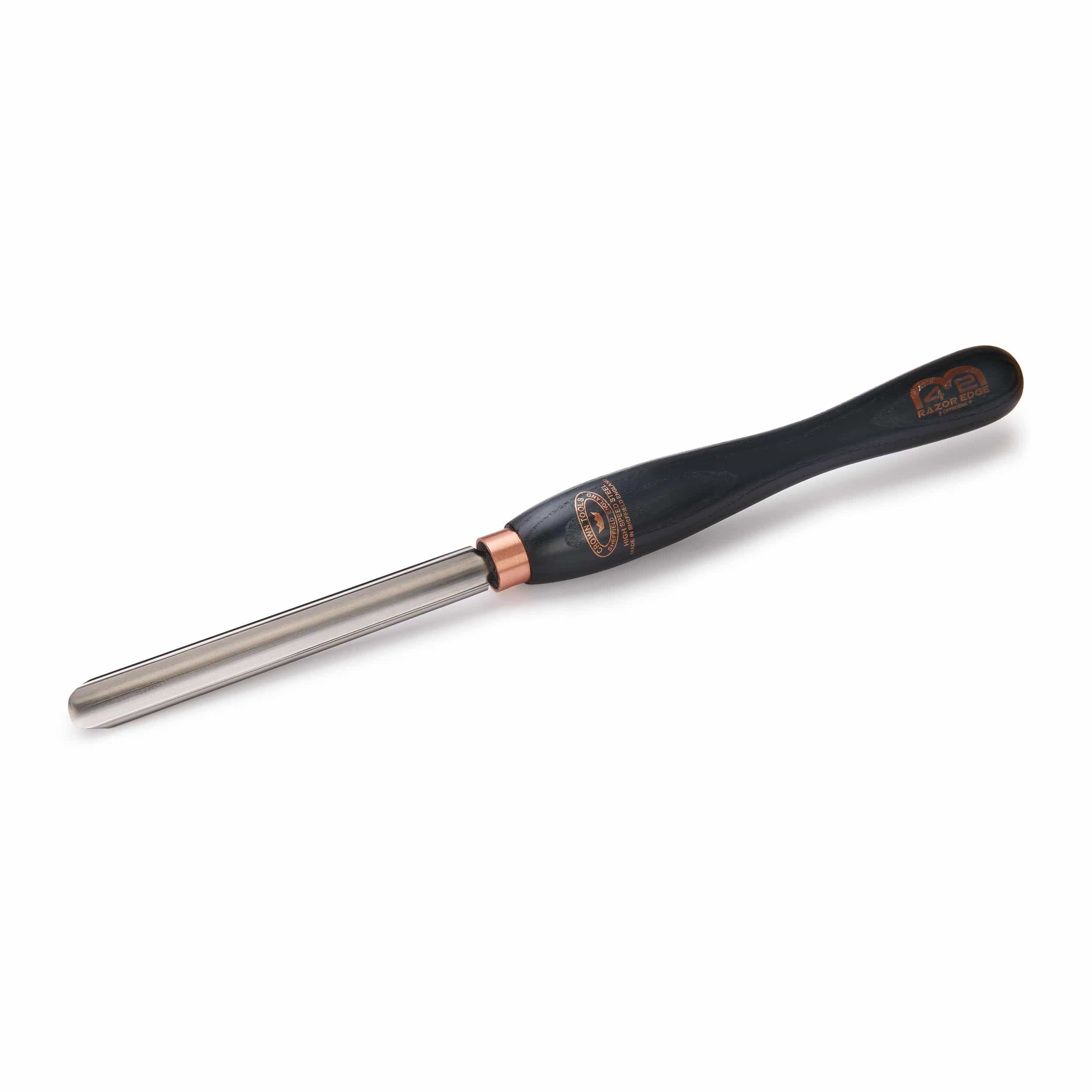

Crown makes a 3/4" one in M42, probably one of my favorite gouges (bought a backup even in case they stop making it).
It seems like all of their M42 offerings drop off after 3/4" though.
You have to go pretty far afield to find it, but you can get a Crown 1 1/4" in M2 Cyro:

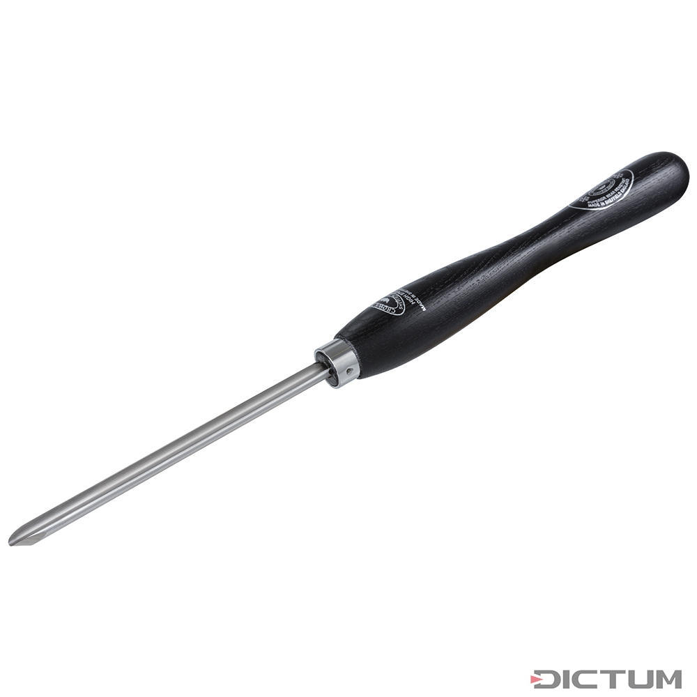

I note that Dictum page lists a range of available sizes for that gouge, including 24mm at €139.00 each
I've looked at those, and others, they're standard spindle gouge shapes and flutes. What I'm looking for is something like in the pics. This was a 1" SRG that I reground and is fairly close to what I understand as a continental flute profile. A bit deeper and I have the wings further back but close. The B&W image is what I'm looking for. Now, all that said, I've never even held much less used a continental gouge but my understand that for what I'm doing, working very long curve profiles over large pieces and needing to remove a good bit of material when needed, they're ideal. I do know that the modified tool I have does work well and I can still work fine cuts with it. I may be over analyzing the issue but thought if I'm going to spend $150 on a tool, try to get the right one for the job.

Randy, the Crown tool that Chris referenced with the Woodcraft link appears to be a continental style gouge. It's described as 'forged', which seems to confirm. Maybe look again as it's pretty much what you asked for.
Dean, I did look at that one and almost picked it up since, as you noticed, it does look like a continental shape and has the tang in the handle which supports it being forged - I think. I might still give it a try. The description didn't give any hints that it was a different flute or shape than a traditional spindle gouge and I've noticed in other sites that sometimes the stock picture might be a bit off. It's still on my list as the next purchase, should I buy another. Thanks!
Chris, forgot to thank you for finding this one. I almost bought it and had not found it yet on my own...might still get it. The 3/4" one looks, from the picture anyway, like what I'm looking for. I think I'll reach out to them and see if can get more info on the actual shape since it just says spindle gouge in the description.

I tried to tell you I have two and they are indeed continental gouges! 😂
I've got the Crown 1" and 1 1/4" as well, just in regular M2 because those were purchased before I did enough digging to find out you can get them in M2 Cryogenic. In the Crown line anyway, there's quite a difference between the 1" and the 1 1/4" (what they will call 24 mm and 32mm). The 24mm still has the shorter Crown spindle tool handle and the 1 1/4" is a much longer handle, quite a bit more tool for just being a 1/4" bigger.
No problem! I can take some pics if you want, but yes, it is 100% a tang in handle continental gouge, not round bar stock.
Chris, my bad for not paying close attention. Well, based on that I'm gonna go ahead and pick up the 3/4" as well... can't have too many gouges is the motto right. Don't tell my wife.
No problem, I totally get what you're saying about they don't always put up a good photo. It should be required / standard for gouges in general to have one photo dead on view of the end so we can see what kind of flutes we're getting. I went ahead and took some pics of the 3/4" M42 gouge (this is the one I linked earlier on Woodcraft) and I can go out to the shop a bit later and get a size comparison of the three I have if you want.
