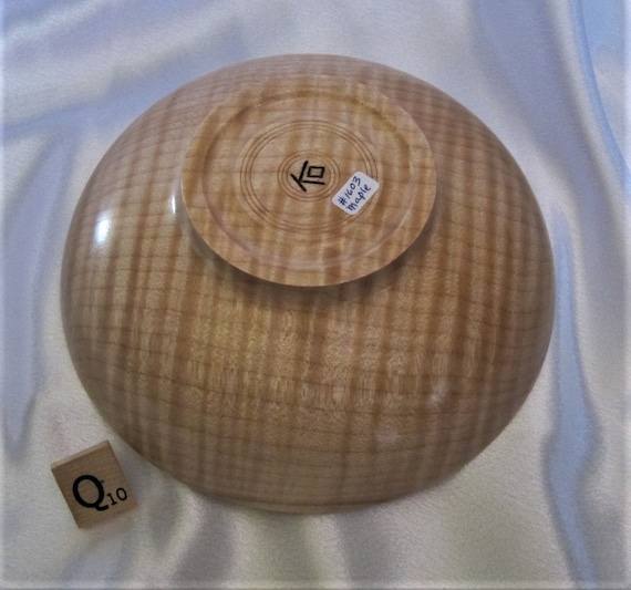

I am in agreement.......simplicity works for me, too.....I don't even do a signature......only a logo with my initials. Nothing more. I've always felt date, number, wood type, along with a signature, looks cluttered. I do understand that many turners feel all this information looks professional.....and, I can't dispute an opinion with another opinion. I apply my opinion to my work, and what others do is ok by me. :D
I use a cub woodburing tool that I bought from CSUSA about 30 years ago.....still works fine.
Very clean and neat Odie!
