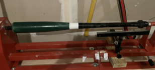

So after much trial and error, and maybe another $100.00 wasted on modifications, here's my rig (with my 3rd bat on the hopper):
I'm sure everyone on here probably knows this already, but you basically divide the blank into 3 inch sections, use the parting tool to grind it down to the proper diameter (handle end is about 1.25", barrel end is ~2.25-2.5". Use a caliper to measure the diameter. Grind, measure, repeat (i can't measure while the lathe is on like some of those guys in the video, the calipers pop up off if they touch the bat). Then chisel the hell out of the areas in between, blend that sucker to make the transition between sections, get close to where you want to be, then go to work with the skew.

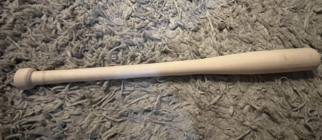

Here's my first one, with the two ends not sawed off. 34" about 38 ounces. Barrel on this was 2.75", so a lot of extra weight
Bat #2, this one is maple, 33", 37 ounces with 2.75" barrel. Knob end not sawed down/finished in this pic. Again much larger than any kid should use (except for those dads that believe they have a superstar 11 year old because he's 5'2' 175lbs and can "swing with the big boys." but can't get around on a 60 mph fastball. My advice to those dads, lay off the nightly cheeseburgers and onion rings, that kid needs to play a position in the field if he want to even make it to High School, much less the Dodgers 2032 opening day roster):
Bat #3, 33", 36 oz. Painted this one and Bat #2, what a mess that was. Still too big for an11-12 year old, but i'm working my way down there. Need to get one of those counter-sink drill bits to cup out the. You can see the nut on the spindle end that I rigged in the below pic
