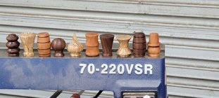

I have a Rikon 12” VS. It has been a good lathe. Think I got it for $600 new. I have put some good size chunks of log on it and it handled everything well. Have turned a lot of bowls up to 12” on it. Had it a few years with zero problems. Here it is with a bunch of bottle stoppers.
