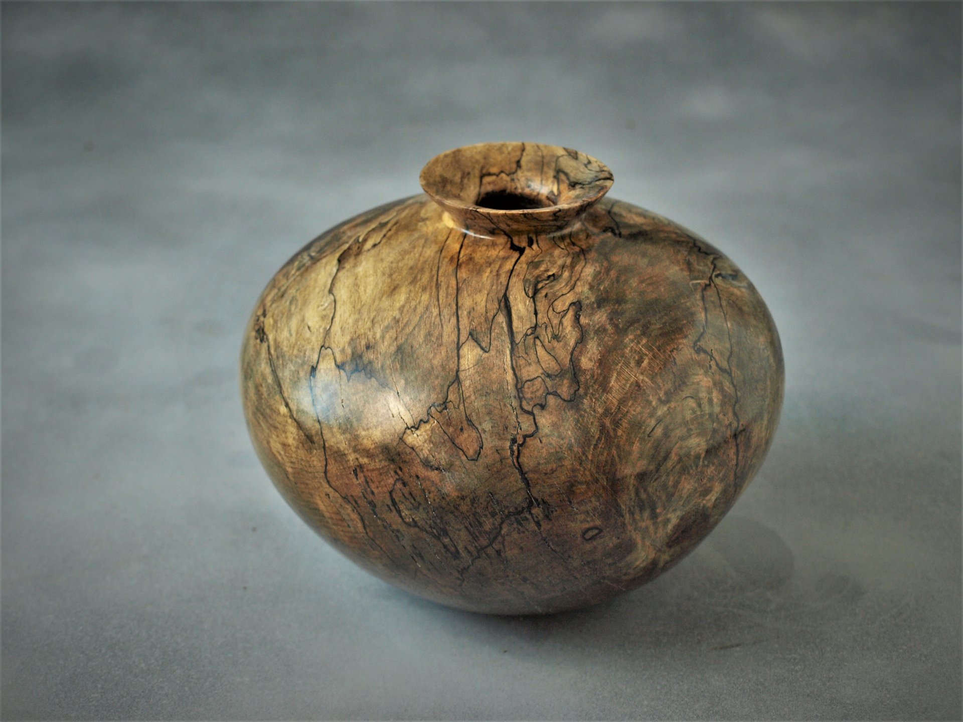

I have had faster results using steel wool that is already a little rusty before putting it into the vinegar. The solution is ready to use after about a day, and gets a little stronger over the next few days and then starts to get weaker as the steel wool is consumed. After a week or so, it is no longer effective. I only make small, batches, about a quarter cup. I for one like the effect of being grey and not black. Here is an example on spalted maple.
