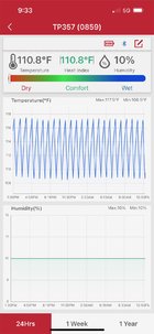

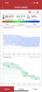

Monty, I believe there are many different cycles that will work. Several things that have been mentioned are important IMO. Weight is the best indicator of drying instead of a pin meter. The amount of weight loss is somewhat a variable as it depends on the initial MC of the wood. I look for 3 days maintaining the same weight. I put a pan of water in as Gerald suggested durning my first cycle. I do run a fan, but not tied to RH, it runs continuously. I don’t think I have ever seen the RH go below 10%, however it may be location dependent or that is the lowest my sensor reads. Have four 1” holes in my top. My kiln has three light bulbs that are independently controlled. For my first two cycles I just need one 40W bulb and the last cycle just one 65W flood.
I just successfully dried two 12” cherry bowls for a friend. Here is the cycle I use:
1. 2 days with kiln closed an d a pan of water. Fan is on and runs for all cycles.
2. 7 days, 95F on and 100F off.
3. 7 days, 100F on and 107F off
4. 7 days 107F on and 115F off
I begin checking weight after 4 days and look for 3 consecutive days with no weigh loss, so the cycle may be more than 7 days.
The first chart shows when the pan of water evaporates. The second photo is the last cycle. Temperature show about 118F high. Controller is set to 115F, difference may be location of meter thermocouple. RH at this cycle shows 10% for the day. I have seen spikes to 14% RH in previous cycles.

I won't try to argue with success but the low humidity levels in your kiln surprise me. At 10% rh and 110*F the equilibrium moisture content should be under 3%, much lower than normal household conditions except in desert areas. Are you drying green bowls at maximum 25% rh with no checking?
Kevin,
Not sure what you mean by “maximum 25% rh”. If you meant 25% MC, then yes I’m drying bowls that are in the 22 -28% MC range.
I am successful. I have dried bowls several time using this cycle. Both of the charts are only one day snapshots. The one showing the 10% was on the last day. There is no way the bowls ever reached any kind of equilibrium in that time frame. Also I let them sit for about a week before turning. Measuring moisture at turning time ranges 6-12%. Humidity inside the kiln is much different winter vs summer. In the summer with the water in the kiln humidity will reach 70-80%, whereas in the winter it will be between 45-55%. From memory the RH at the end of the cycle in summer was about 25% My shop is not air-conditioned in the summer, but heated to 60F in the winter. I have dried bowls in both seasons without checking. Mostly cherry and maple. Haven’t had any walnut to try, IMO the real test.
The only way for to keep the humidity up would be add water on a daily basis. It has not been necessary for me to that.

I misunderstood your post, sorry. Your first chart showed RH ranging from a high of 25% to a low of 14% for one day, no doubt at the end of the kiln cycle. I mistook that chart for a range over the whole cycle. Your last post explains your process more thoroughly and agrees with my experience drying lumber in a solar kiln, with high humidity early in the cycle and low RH at the end. Thanks for straightening me out.
