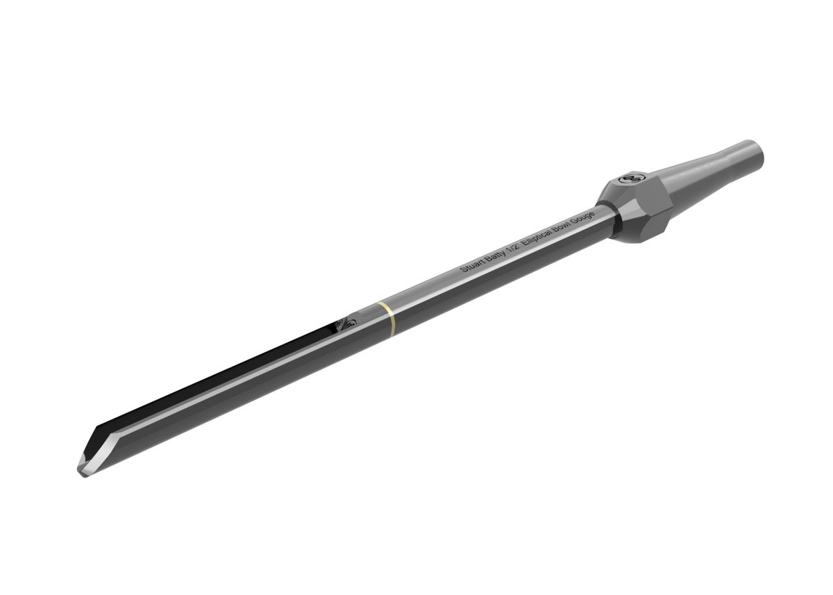

Nearest to San Mai in a woodturning tool is/will be Stuart Batty's 15V steel laminated to stainless steel.
Anyone used one yet?
It looks like he has gone for the tip tool set up. One of the major benefits here is that would allow the tip to be maximum hardness on a softer mainshaft. Something you cant do with conventional tool making due to brittleness. I see this as a trend as there are several toolmakers going this way and 15v has to superior to the more common 10v. Plus given that the gouge is laminated it should make something akin to the Japanese art of making swords. An interesting concept, StuartB is no fool with many years behind him so I hope its an innovative as claimed. Reading through the blurb I would say hes onto a winner, if only in design..
