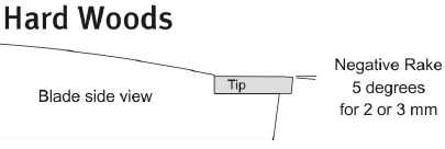

The instructions state to create a 5 deg angle on top of the cutter for hard woods. Does this mean for wood classified as hardwood, or harder wood from a # on the Janka scale?

In terms of the 5 degree cutter angle, yes that is for wood 'classified' as hardwood.
