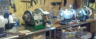

This is an old picture before I settled into my current system (and gave one bench grinder to a friend):
I built a thing from wood to allow me to use the Tormek gouge jig on one bench grinder if needed.
I have a spare Tormek I may set up for more flexibiity if I get some time.
I keep two conventional bench grinders with non-CBN wheels for grinding many non-HSS things, one in the turning shop and one in my little welding shop.
I use a belt/disk sander with a 1” belt and 6” disk to shape curved hand scrapers and sharpen axes and things. I use other belt/disk sanders only for wood.
My last sharpening device in the shop is not related to woodturning: it's a specialized knife sharpener that uses three 1x30" belts and an interesting method that puts razor sharp edges on any non-serrated edge. It's hard to believe how sharp an edge it can put on a knife.

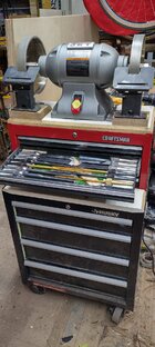

But the bullet and bought the 200 grit D-way CBN wheel. Damn thing weighs 17 pounds. Takes a few minutes to stop turning due to inertia.
I suppose I should have mentioned above, all 4 of those cbn wheels came from woodturnerswonders and weight is reasonable. Even on the large 10" wheel for the tormek, nowhere near 17 pounds.
The d-way 10" wheels are somewhat lighter than my 8" super square and 4 way radius wheels from woodturners wonders. Then again 1.5hp takes about 4 seconds to come up to speed.
