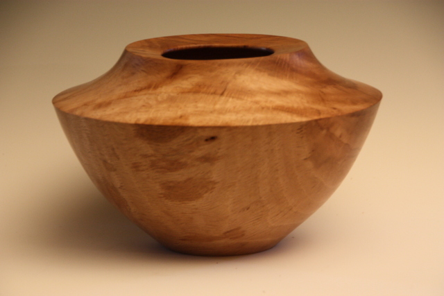

Oak does turn well, but there are exceptions. I have seen nice bowls in red oak but with the grain and the amount of movement you get there are better things to turn. White oaks of which live oak is one has an interlocking grain and will give some fantastic effects. Yes it moves too .
The second shows the amount of movement which turned this one into a football, but the grain popped out like it was woven so I just sanded a bit and left it that way.
