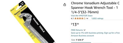

check this out.
I’ve done it and it works.
