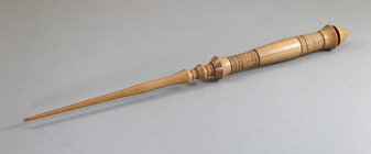

And thin spindles can be challenging to many - until they know how! (... hint: no steady rest used or needed ...)
Here's a closeup of her second wand: eastern red cedar with "distressed" texturing. Looks perfect to me.
