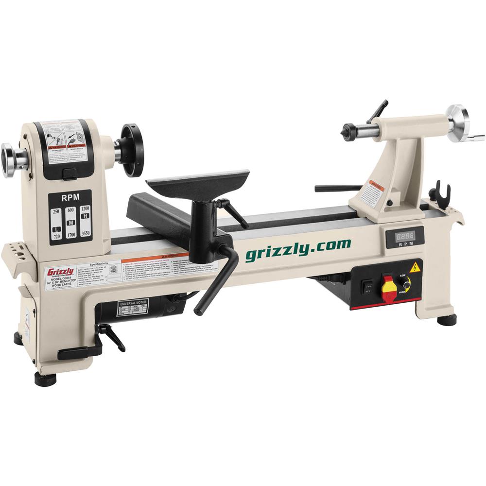

If you don't mind different paint, here is what looks like the exact same machine from Grizzly for $725:
With shipping the price comes in almost the same as the Wahuda with shipping. The Wahuda has VFR motor control and a slightly larger spindle. Axminster advertises its same lathe as the Wahuda as a professional grade lathe.

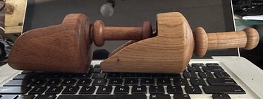

I’m currently working on a cherry kitchen utensil canister with two cherry spatulas and two cooking spoons, for a friend of a friend. She insisted on paying twice what I would have asked for the set.
Another guy wanted three of my kitchen scoops that have a second axis elevated scoop handle (versus a traditional wood turned kitchen dry goods scoop). Again, he insisted on paying twice what I would have asked.
Another friend asked me for the cherry canister and utensils set, as well as three elevated handle kitchen scoops. She’s paying what the first two offered.
And I’ve gotten numerous requests for my cigar ashtray design:
