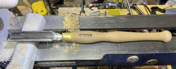

As for the OP, I've been using a moderately-priced Narex SRG I bought at my local lumberyard. It's well-made and takes a very sharp edge. I'm not sure why Narex turning tools aren't more widely available in the US. Their bench chisels are very popular and considered a great bang for the buck, but I haven't seen Narex turning tools online and it just happens that I live near one of their few US distributors.

I'm no great spindle turner, but I can usually get a very nice finish off of my SRG. The trick is presenting the cutting edge at an angle, taking slow and light cuts, and keeping the lathe speed as high as possible.
Highland hardwoods?
Really nice lady on the phone. No online sales unfortunately.

There seems to be a few models of the crown ones. I've found a 231w model which I guess is the beginning level I thought but hartville hardware sells one called an oversize roughing gouge and the handle doesn't have the same markings as the 231w. Both of those were 1 1/4. Then there is the cryo model with the black handle and also there is an m42 version called RAZR but I don't think it comes in 1 1/4.
The pinnacle brand looks pretty identical to the crown cryo as well.
The nice lady in new hampshire where they sell narex is going to get back with me on cost of shipping one. The tool itself was mid range price I'd say. I think they are made in the Czech Republic or somewhere like that. Might be better steel than Chinese offerings? (I know crown is English)
The nice lady in new hampshire where they sell narex is going to get back with me on cost of shipping one to me. I think they are made in the Czech Republic or somewhere like that. Might be better steel than Chinese offerings? (I know crown is English)
That’s an interesting handle shape. I may have to make one like that.
1,373
3,981
Interesting! I didn’t know narex made turning tools. From what I read a while ago, their bench chisels are a great bang for the buck. I suppose a SRG would be the same.
Interesting. I have never seen a Narex turning tool. Did she know what metal it is?
You are correct, most (all that I know) Narex are Czech, Crown and Sorby English, and all should be better (at least more consistent) than Chinese tools.

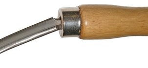

The Thompson, P&N, and Carter & Sons all have round tangs. Many others have flat tangs. Unless the flat tang is way out of the handle, changing to a new handle won't strengthen it - which as you discussed is the weak point of these tools. Note it is the tang itself, not the handle that is the weak point.
Used properly, the tang shouldn't be weak enough to break, but a bad catch, or letting the tool get caught between spinning wood and tool rest will result in flying broken steel.
I would only consider those three SRG's for that reason... for their substantial milled, not pressed, tangs. The press forged tangs are at risk of doing this....
I also still have my 35yr+ old P&N 1-1/4" SRG that will outlast me. They no longer make those, but a second hand one of those would be a great find. Mine lost some of its length from sharpening before I moved over to diamond wheels 15yrs ago and then to CBN.
A 3/4" bowl gouge can also be used quite effectively as an SRG. This is a good option for those who don't do much spindle work and more likely to have some use for a larger BG. The price of a good 3/4" BG is also very competitive compared to a dedicated 1-1/4" SRG.
I have also used a Crown 1" and 7/8" BGs for that purpose, but most bowl turners don't need a BG of that size unless they are doing a lot of large green bowl/platter turning.
An alternative to an SRG for doing fine finishing cuts on the outside of forms is a ' continental' gouge. They are forged from flat bar, but their tangs are less of an issue when used for that purpose. Their flutes are much shallower than SRGs and are up to 1-1/4" wide and that gives a lot of fresh edge to work with and again are much cheaper than a good SRG that has a milled tang.
Discussions on the use of SRGs anywhere near grosgrain work raises safety issues and is also likely to cause some controversy, so I'll ponder on that for a bit before venturing into making any comments on that.
