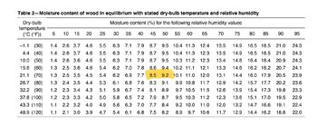

received a couple of nice blanks ( olive wood and figured walnut). Do I wait it out for drying? Twice turn
Wood MC will get in equilibrium with its environment over time.
You will want your wood dried to 8-9% MC
That way the lids will continue to turn inside the average home.
Twice turning and drying in a suitable environment will work
If you have high MC, the lids and base if turned with the same grain orientation will warp in the same directions.
Slightly Loose fitting lids will usually be fine. Lids may not turn but will go on and off in the same grain orientation.
This table shows the MC equilibrium in a table of environments. Check you drying room against the chart.
