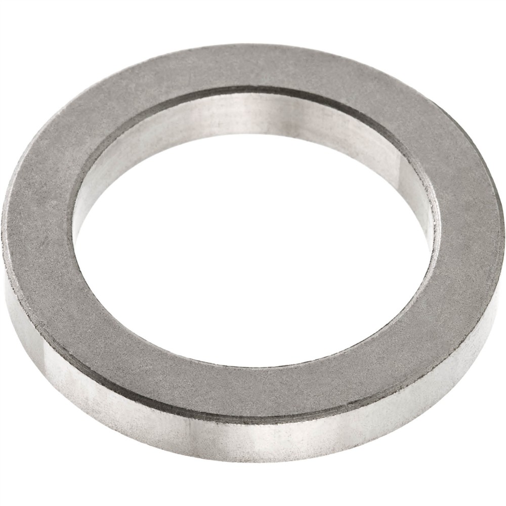

None of my set screws on my 3 nova chucks line up with the shoulder they are supposed to tighten to. They are right on the edge so they mess up the edge on the shoulder. I cannot seem to find a spacer that I need for this. I'm guessing I can't just use any washer, as they are not machined to flatness. It needs to be pushed out toward the end of the spindle about 3/16" to be in the right spot for the set screws. The lathe is a Harvey T60-s.

Just barely snug up the screws, you don't need to torque them down to be effective. You could also use a brass plug or nylon tipped set screw.

The little thingy that comes with nova chucks that is supposed to go down the hole prior to the set screw is essentially gasket material cut to about a 1/8" diameter disc. (might be just a tad larger) It's hard to imagine that it makes much of a difference, but that's what Nova thinks we should use.

You could turn a brass or aluminum spacer on your wood lathe if you can't find what you need.
A machine shop would use a round bar stock and drill a hole the diameter of your spindle and then part off the thickness of the needed spacer.
Another option is to find some flat stock the thickness you need and drill a center hole in the material then secure on a spindle or chuck and turn the outer diameter round.
The flat stock method would eliminate the problem of machining a flat surface and parting off the spacer with a hand held tool.
You can use carbide tools to easily turn/cut/machine brass or aluminum and your wood lathe has plenty of torque to turn smaller pieces.
Another option for a spindle chuck spacer is a hard polymer material which can also easily be turned on a wood lathe. I have several 3/16" thick spacers that I still use
that were turned from Corian type materials. Both sides of the spacer mate up against a flat surface so they are still in good shape after a number of years of regular use.
I did use those little red dots. They fall out as soon as you take the chuck off into sawdust land! But they do work if you crank down on the set screw.

Once you have a sheet of gasket material from the auto parts store to make your discs, you can punch one out with a variety of purchased punches, or you can use spent firearm brass. Rimfire 22 brass is pretty soft but 223 works well. If you know someone who likes to shoot, they almost certainly have an AR15 and 223 brass.

Of course the OP could drill and tap a hole in the right place, never have to get a washer etc to fit in there after, just a one time job.

McMaster Carr has set screws with either brass or nylon tips - a bag costs a few bucks. I seldom use them, but they’re in all the chucks I use. The occasional reverse turning large, heavy blanks on a lathe with braking resistors taught me to anticipate the possibility of a chunk with a seven pound chuck bouncing around the shop. I only bother to tighten them when there’s a potential wanderer on the lathe, but glad I got them.

I have never used setscrews on a chuck, but if you do then don't use the typical hardware store setscrews that have a sharp cup tip. That type of setscrew is meant for digging in and deforming metal in order to permanently hold parts together. As others have suggested, go to McMaster-Carr to get setscrews with either a dog point or rounded tip or a softer material like brass or nylon.

I do have more than a few chucks that use a locking grub screw and I use them with the little leather circles. Just order 50 brass grub screws off Ebay for $12.59.
If I understand your problem I think you need a machined "arbor spacer(s)". I have some in 1" & 1¼" ID in several thicknesses. I used to buy them from Grizzly because they were cheaper. Just checked and they only have limited thicknesses but I'm sure MSC or McMaster-Carr has many more sizes - just cost a little more. I use them on my spindle when I use a few of my spindle adapters. I also use them on my 1" toolrest post when needed - held on with a small RE magnet.

I did order one of those from grizzly. I have bought a couple of axminster 114 chucks and the set screws do not have the same location as the Nova SN2 chucks. It is farther away from the threads on the spindle.
