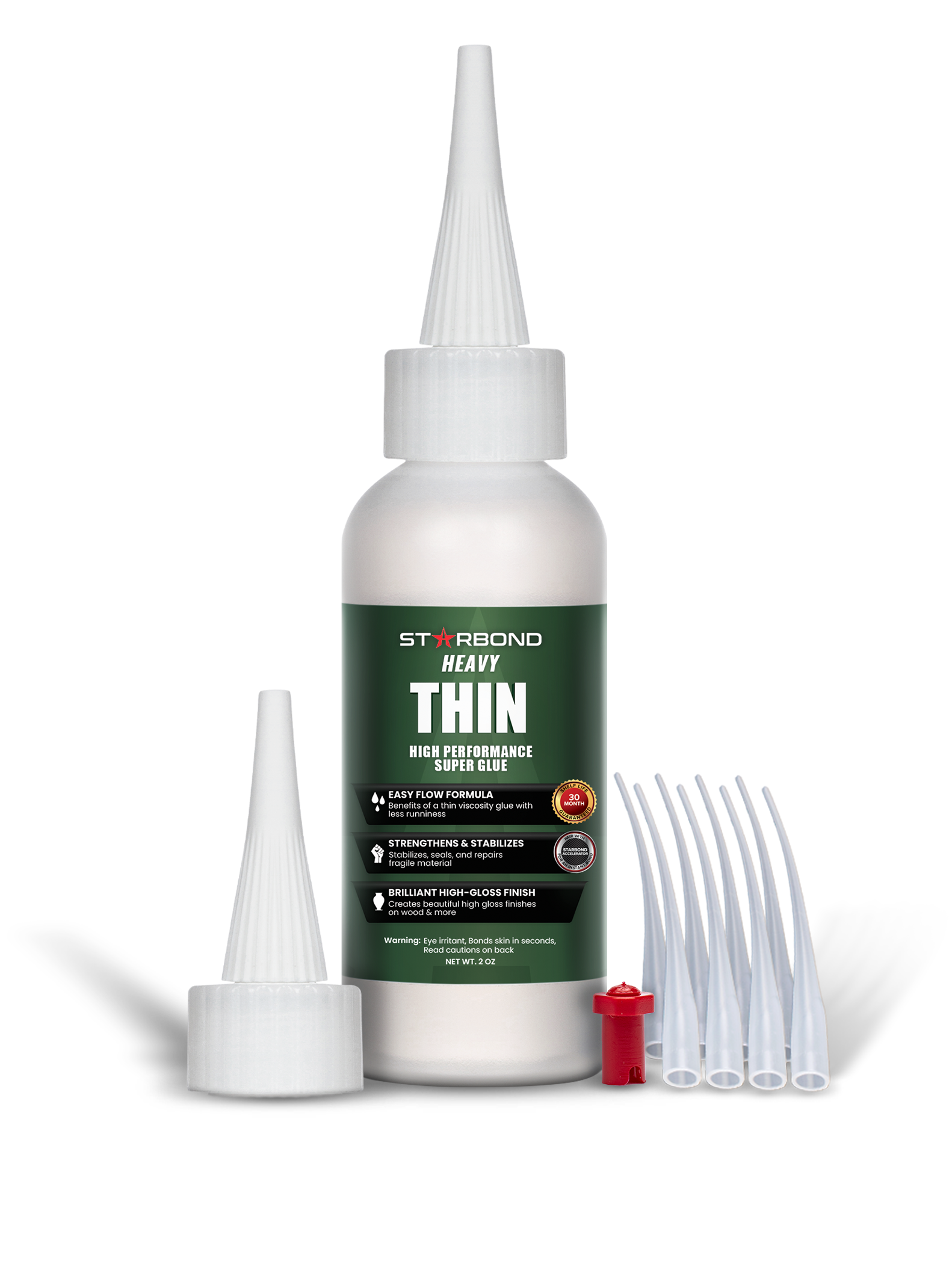

Starbond heavy thin is what I switched to after the thin ca always finding a way to the other side of the blank, and my hand.
I did the same thing. The only time I use the thin is if I want it to soak into the wood, like for a threaded hole in a jig, etc., or if I think it's been too long since I "inadvertently glued body parts together". :p

"heavy thin" ??
I'm not sure if links are allowed? This is it....
2,451
1,880
Starbond has CA glues in a wide range of viscosities. The thin is so thin it's really unusable, at least in (and on) my hands, but if you have an application that truly needs CA that's thin as water, they've got it. The Heavy Thin is more like other brands 'thin.'
To get more specific:
Starbond thin, aka Superfast thin EM-02, has a viscosity of 2 cP, almost as low as water which has viscosity of 1 cP. It wicks into cracks like crazy.
The EM-40 Heavy thin has a viscosity of 40 cP, similar to olive oil according to Starbond. I haven't used this.
I like the N/0-05 grade. At 5 cP it is noticeably thicker (to me) than the Superfast thin and doesn't wick as well into fine cracks But I like it because it is odorless...no irritating fumes.
