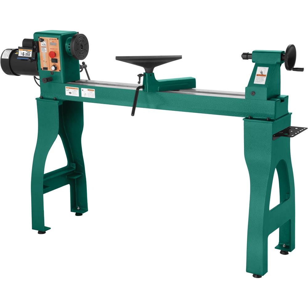

When grizzly advertises this as a 16' lathe and I i am unable to load a 12" blank that I prepared round and balanced on a band saw. when I am unable to even load that blank on the lathe because of interference from the tailstock, that is false advertising. The blank had to be cut again to 11.5" to begin to turn it on a lathe that is advertised as 16". That doesn't take into account the 4 breaks of cast parts during operation of this lathe.
Please elaborate on what caused the interference with the tailstock - suspect its the way the casting protrudes under the live center with the quill retracted - yes a poor design but can be worked around.
All lathes have the swing reduced by the banjo height. As long as the spindle center is 8” above the bed the swing is 16”. TS design and clearance over the banjo are things for you to look for in your next lathe.
As for the casting breaks, could well be casting defects - large inclusions and/or cold flow are 2 common occurrences, both traceable to poor mfg process control. Without inspection (easy to see) I can’t say. The molds for this lathe are probably pretty old which exacerbates these types of issues. Casting mfg defect (not design) is the approach to use on Grizzly to get warranty coverage.
8,655
5,017
C148647D-7AFC-4088-BFB4-87F529E02BA7.jpeg. This is a poor design.
I turn on lots of lathes.
The powermatic requires the quill to be out a long way to to use a short tool rest when reverse turning the bottom of a bowl because the banjo hits the tailstock with the quil at normal extension - quirk in this design doesn’t make it a bad lathe. Quills vibrate less with least least extension.
Using this tailstock I would probably use a Morse taper extender. I use them on occasion when I want to use the tail center or spur drive inside a natural or turned hollow. My Morse taper extension would probably introduce less vibration than extending the quill on this machine.
. Oddly limiting factor on this lathe is the tool rest post. But the photos show an offset add on to add more distance.
No mention of the tailstock. But all lathes loose a couple inches of swing to clear the banjo.

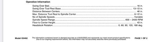

The spec from grizzly
8,655
5,017
I see you are a Grizzly disciple
You could not be more wrong!
I just added specs on swing from the grizzly site.
I did not see anything in the grizzly specs I posted that would support recommending this lathe to anyone.
I have never considered grizzly as making a machine I would want to use
Bad design = bad machine

I would remove the quill and reverse it 180° so that it sticks out the other end.
I had the thought that the TS is backwards too.
Usually the casting hole is smaller diameter on the Handwheel side
Do you know if is it is possible reverse the quill?
When I look ar the Grizzly parts diagram
My guess is the lead screw - 96v2 has a shoulder that holds it in the casting
and the handwheel holds it from the other side when
Set screw 76v2 locks it on
The quill lock 75v2 could be moved by drilling and taping a hole on the opposite side.

I discussed this fix with Grizzly tech support and they say can't be fixed without redesign which we know would be a simple 180 degree rotation as I believe you suggest but that's all a moot point as I have just purchased an American Beauty, and will deal with Grizzly in the coming days.
