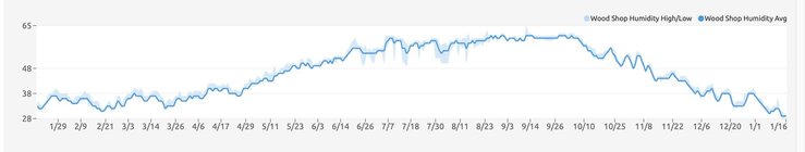

FWIW, here's what the humidity in my heated but not humidified shop looked like for the last year in MA. Ranged from 30% in winter to 60% in summer. The last few days went quite low because I cranked the heat up for a major finishing project. Normal daytime temp is ~64-65 in the shop in winter.
Hi Roger. I really appreciate you sending the year of data on shop humidity. I'll have to experiment with active vs. passive humidification, and see what works best. Thank you , Larry
