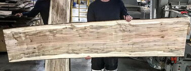

Lowell I do not believe you have any Cherry wood there, I do believe you have some Silver Maple, it has that slight pink color in it, nice bowl like that with the rounded edge.
I wonder if this piece comes from, or close by a crotch and the brown pith stains that are showing, not Ambrosia stain I believe, as there are no beetle openings as far as I can see.
You can compare your wood with the Cherry below.
Silver Maple infected with Ambrosia beetle and stained, the beetle openings are clearly to see, note the light pink color of that Maple board.

BINGO! Yes, my daughter's neighbor had a major part of a maple tree come down in a wind storm, and another neighbor two houses down has a Silver Maple that lost a big limb and I helped clean that up and it ended up in my wood storage. I had forgotten about that. Thanks Leo, your spot on!
