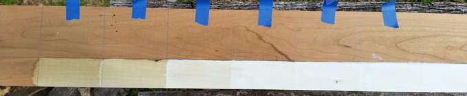

As Al said, use a foam brush, a regular paint brush can fling droplets. Mixing your own is less expensive, especially if a few split the cost. Label, label label any container you transfer chemicals into. If you have any qualms about using lye, check out some soap making websites. The stuff won't jump out of the container, but you do want to treat it with respect. If it gets on your skin, wash it off, don't waste time neutralizing, copious amounts of water, dilution is the solution... then, if the area is irritated, treat like a thermal burn. Wear eye pro and have a direct path to a sink sprayer so if the worst does happen, you are already prepared. Key word, copious... Treat with respect, plan ahead...
Here is a cherry board, after the forth application, there wasn't much of a change.
