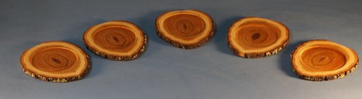

I thought I had come up with a neat way to make coasters from small trees ( in this case it was northern red oak) or limb wood but this summer I put a glass of ice water on one and forgot it. The condensation soaked thru, the wood expanded and cracked in the sap wood area but the crack closed up when it dried.
