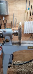

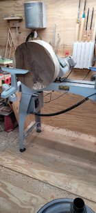

This will be my largest turning to date. It was around 18” by 3.5”.
Keep in mind that feather grain is often very thin
If you put a 1/2” tenon on the face we’re looking at you will loose much of the feather.
I using a glue block and a footless bottom will show som feather on the inside of a thin walled piece.

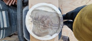

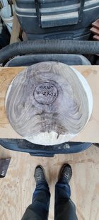

Here it is rough turned.
Will be @ nice piece
Nice thick flame. You have lots of flame on the inside. You always get a bit more flame on the bottom.
As you know with these pieces the figured grain puts the grain in different directions so some grains will be cut in the wrong direction and may tear instead of cut.
Light cuts, sharp tools.
I find I can cut about 80% of the crotch bowls using a gouge without tearout. I end up switching to a scraper on the other 20% before the bottom gets too thin.

Thanks for the tips. I have a negative rake scraper I will try if I have a problem area.
