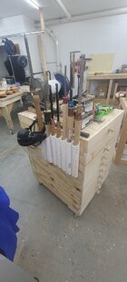

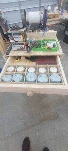

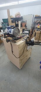

My tools are largely on the wall due the lack of space. The turning bench incorporates all my chucks and any area to place tools in use, I have two grinders and they are on wheels
