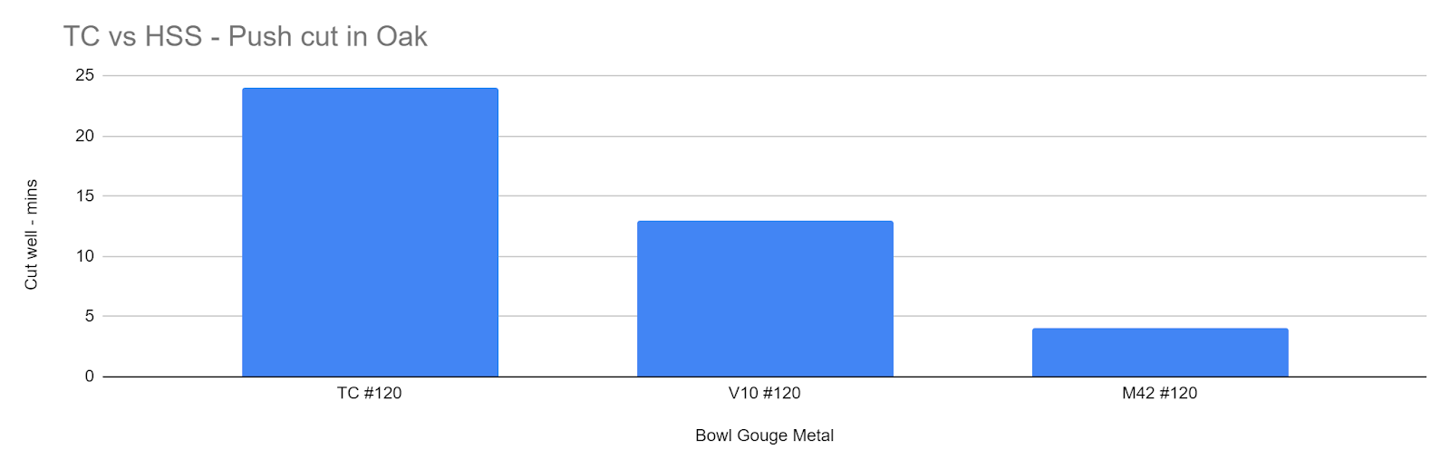

For those who would just like to see a summary of the results,
here they are...

O2TR-0XTBo_kxlnaVKX_LfwfpLlW2yn6JlteDd4KhETuyChH83jtJFB-uxb0-lOkXpB6yzY94hOCoBEuOdwMXJou5mHXSMIKOtRhHaeQbJP2N747VCISvuuJ6vFh_BEJ05GtgVuGHcPr_U6ztg-aXdk
The results for the TC on that old abrasive filled river redgum railway sleeper may not look significant when seen against its performance on the medium to softer woods, but it was still two to four times better than the other two, albeit with all of them struggling with that task. Previously the TC had not always outperformed the other two gouge metals on the medium to soft woods, but it pulled away from the others after being sharpened on the #1k diamond.

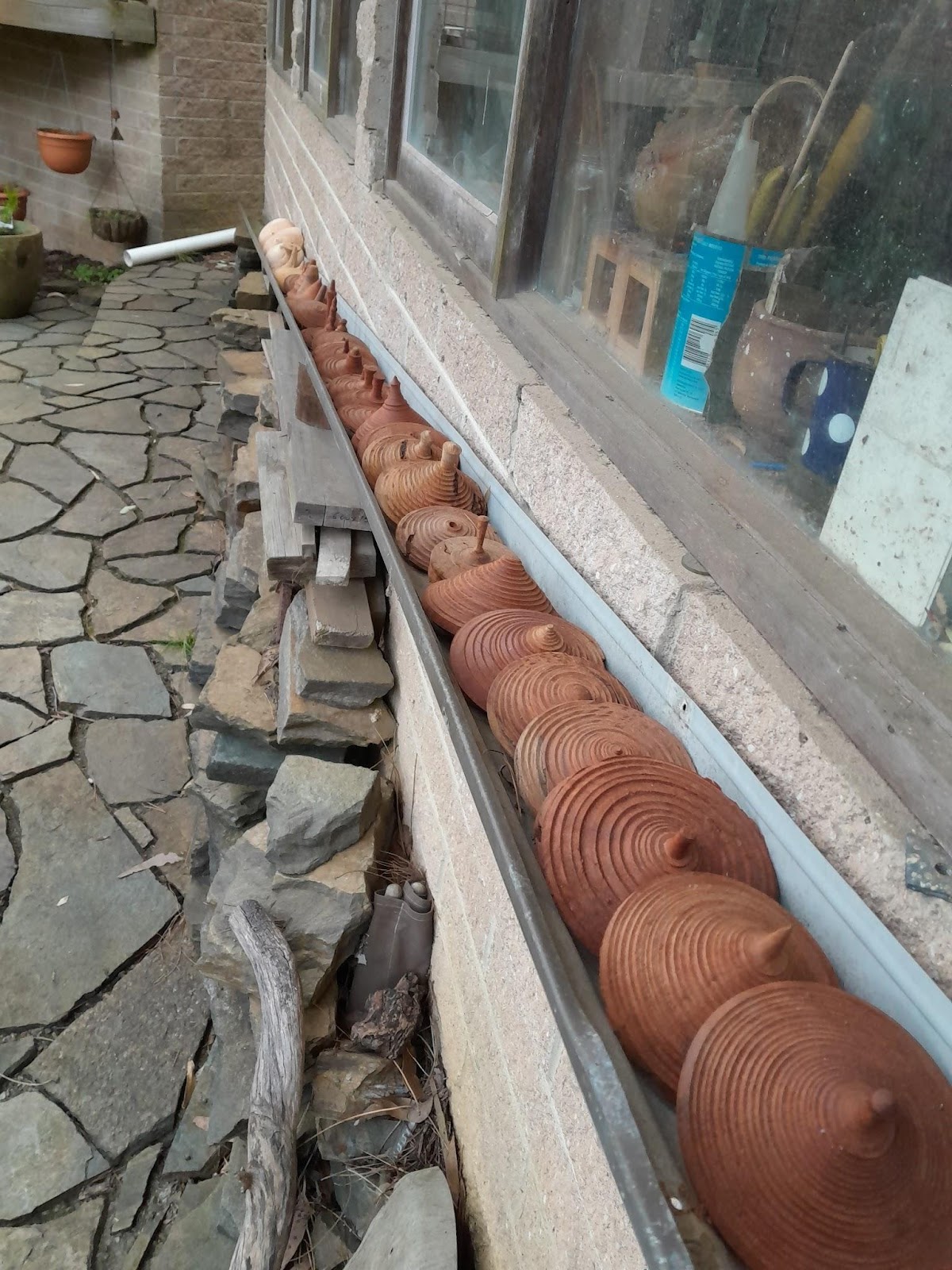

With most ending up looking like this, lots and lots of them
QZZIJIrSA56WEVazWoA6aefJCwsXT3LjW6BIb5BGufYNrUsyMoKIImfv_qAt8zvC6cT9x76HHC9DRGnC6El-YQK7Lwf17RUO26dzqsc8ppeZpvmocmikbucAX6KEak5UOkNOeaer_ZI6d9adieqplpc
I can’t honestly say that no wood was harmed in carrying out these test runs. At last count I am close to fifty very good wood blanks or pre-turned pieces that have been sacrificed to the cause!

As described briefly in my initial post, my testing protocol involves freshly sharpening all of the gouges and then using them in short stopwatch timed rotations to ensure that each gets equal exposure to any of the more difficult areas of the blanks. For the hard to medium woods the rotations are in timed intervals of 30sec. I disengage the cut on hearing the buzzer and record it and repeat with the next gouge, and so on in rotation until a gouge can no longer raise shavings and remove wood, at which point it is eliminated. Here is a typical score sheet for the 30sec rotations…
The score sheets were transcribed into tables like this…
TC vs HSS - Push cut in Oak
Bowl Gouge MetalCut well - minutes
TC #12024
V10 #12013
M42 #1204
And a graph produced from that for each wood…
rXlIHT0HWao9g72ir7qxU3Xv4Ls12V4Z0DDyaXzkGg8-cJeeuhE26G9QXd3plTwopA2hjlwPIzSCzmtaFLsZBjOCzcE-nD8q6PI8iUgy0RxE4LpFY9xnuBSjRqpyOZdbcdzxL4cO-eCwI6RYXeMB_Jw

After completing the first round of testing I consolidated all of my test results into one table that looked like this…
Series of tests with gouges off #120 diamond
RG sleeperRGOakEucalyptAsh/MapleBlackwoodPine
Bowl Gouge MetalExtremely HardVery HardToughMedium HardMediumMedium SoftSoft
TC9302434.5243936
V101.551313.5161933
M420.53410161433
From which the graph in my initial post was derived.

The improvement was closer to a three fold improvement for M42 off #1k sintered diamond over #120 diamond resin matrix.
Here is the data for the three steels. All sharpening for these tests was done on diamond.
Improvement in performance with #1,000 over #120
WoodTC off #120TC off #1kV10 off #120V10 off #1kM42 off #120M42 off #1k
Ext Hard Redgum9181.54.50.58
Oak24841312411
Soft Pine3610033503335
And, shown here as a graph...
However, as I didn't use a #1k CBN wheel to sharpen the M42 shown in these tests results I can't say if M42 would have a similar improvement of almost three fold in cutting time if sharpened on CBN.

I find that, once I have shaped my tools on lower grit wheels, the 600 grit wheel is all that I need: a few seconds on a 600 grit wheel puts on a new edge with minimal loss of steel. I don't keep track of whether this edge cuts longer than an edge from my 180 grit wheel, but your data suggests that it probably does. I hadn't thought a 1000 grit wheel would be useful, but if data like your comes out for CBN wheels, a 1000 grit wheel might be in order.
I think I might know why there was a quantum leap in edge durability when the TC is taken down to #1k on diamond, but it is a bit beyond the scope of this thread to go into that here other than to say that I found it to be the case during my testing.
In the case of the TC, I took it through both #600 and #800 diamond without any observable improvement before the #1k diamond, where there was a definite two to three fold improvement.
With the two HSS gouges that I used for the test runs, I went straight from #240 diamond down to #1k diamond. Having found the sudden improvement with the TC off the #1k I wanted to see if it was just an anomaly for the TC or if there would be a similar improvement for the HSS at #1k, which there was to varying degrees.
What I didn't do was step through the #600 and #800 diamond with the HSS gouges, so I can't say unless I went back to do that that the same quantum improvement which was observed with the TC would apply to the HSS gouges going from #600 and #800 diamond down to #1k diamond.
Also, none of the test data was off CBN sharpened gouges. The results off CBN could be very different for HSS. Many like yourself, Gord, who have a #600 CBN wheel report the benefits of going down to that grit with their HSS gouges.
An economical way for anyone who would like to experiment to see if going down to #1k CBN would provide any further benefit over #600 for their HSS would be to get a #1,000/1,200 CBN hone and just hand hone the bevel with that. And, we can all do with another hand hone!
Note: Gouge flutes should be taken down to as fine a grit as that used on the bevel side of the edge. I took the flutes on the TC gouges that I used in my tests runs down to a 5micron finish with loose diamond powder suspended in wax, which is equivalent to #1,200 grit. This is what gave them that mirror finish you can see back in post #4. You wouldn't need to use loose diamond for the HSS flutes, but it is much cheaper than you would expect if you look for a reasonably priced source.
I was actually thinking about it after researching the loose diamond powder on Amazon... but what I had in mind was a custom-fit gouge hone , where you would set your preferred grind and then make a casting of the gouge end and flute, and use that casting to make a 3-piece mold (external block shape, and top & bottom flute/bevel shapes), and then mix some suitable epoxy and mix in your loose diamond grit , keep the whole thing by the lathe and when you wanna hone, just stick your gouge in your custom mold and give it a few twists back and forth.... and go back to cutting with a nicely honed edge... epoxy profiled hone could help retain and polish your grind so well that you may never need to go back to the grinder unless you nicked your gouge badly, or wanted to change profile (in which case you'd need to make a new custom hone)
But, I just have not really had the free time to mess around with the idea (And epoxy costing more than the diamond grit, I haven't been willing to spend the money on it yet either)
Terry Martin wrote "Rethinking Sharpening" in the June 2014 issue of Am Woodturner. He describes his own experience with using the Tormek, which I believe is similar to a 1000 grit diamond finish. He is convinced that polishing a gouge to a higher finish lasts longer. He also refers to an article by R Farrance with sophisticated tests that show a finer edge lasts longer.
Definitely food for thought here Brian
That is what I do for power honing the flutes on all of my gouges and in the case of TC the abrasive just needs to be diamond rather than chromium oxide, etc...
I have developed something very similar, finding MDF ideal for conforming to the shape I require.
only logical if you are starting finer that it takes longer to get to dull—just like if you are driving faster, it takes longer to get to zero.
Michael and Alan
I have responded to your posts over in the companion thread on sharpening TC gouges because it relates more specifically to that sharpening thread...
When the #800 diamond disc arrived I tested the edge off that against the #1k and found that the edge off the #1k was the standout performer there.
I have since tested the use of a #1.5k diamond disc compared to #1k disc, which I have reported on in the companion thread on sharpening TC…
