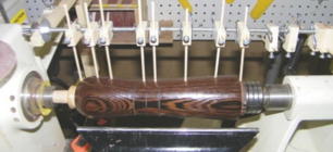

In a thread that later went far afield (which is OK), @Adrian Wilson quickly identified the "mystery thing" I saw in this video. It was obviously a short-cut to using calipers to make identical copies of an item. After Adrian's post I was able to find a video of a shop-made Spindle Dancer Jig. Perhaps too much trouble for a casual duplication, but great for quickly making several multiples!!

That is a pretty clever jig, and doesn't look too difficult to cobble together. The fingers could be make from dowel rod, and thumb screws rather than slotted screws would make for fast setting and adjustment.
A 1948 Delta publication showed a jig of this type they offered, they called it a semaphore jig.
They also called segment turning "built up turnings".
