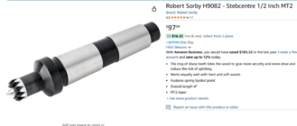

Hi, a recent thread got me interested in steb centers. It seems that there are two brands out there sorby steb centers which are around $80 and Chinese steb centers which are around $20.
Now I'm no fan of exporting us jobs to a autocratic 1st world power to be performed by children. But that ship has sailed. I'm willing to spend more on better tools or better quality. But is there really $60 worth of better quality in a steb center?
Much of the problem is not the steb, rather the mt2 is a distant resemblance to an accurate taper. Taiwan machined mt2 seems to be more hit than miss, but mainland production might as well be a snowcone. Penn state is about as imported as I have been successful.
