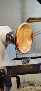

I am making a couple of bowls from Sassafras’s and I was wondering what is the best finish for them?
Normally I use a 3ish coats of buffed shellac and several coats of bees wax for my bowl finish but I have never worked with sassafras before.
Thanks for any and all suggestions.
Bob
Finish like you would any other porous wood. I’ve only turned Sassafras a handful of times, but the blanks I had were on the lighter side. I coated with shellac, sanded it back, and then finished with rattle lacquer. This kept the color on the light side. Oil would’ve yellowed just a bit, of course.

Thank you for the response. I love your work. That is an elegant piece.
I was making some heart bowls that @David Wyke was kind enough to share the process for and I thought I would try sassafras as the blanks were inexpensive. It is great to hear what works for others, and just as important what doesn’t work well
Thank you Bob! As you know, finishes are situational. I have some other Sassafras that has a lot of color (browns and grays), and I’ll probably use an oil finish on that to enhance the contrast. Yellowing included without worries.
