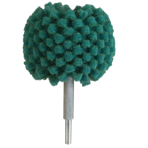

I was going to mention abrasive balls...they can go from 60 grit to 320 and even higher
https://www.ptreeusa.com/images/10933_scuff_ball_green_300.jpg

Emiliano, they do hold up pretty well. I have used them a few times, and have them available when needed, but to be honest, I have learned to use the Hunter cupped carbide tools on the inside of hollow forms in a shear scraping angle, and a few passes makes all the ridges from the hollowing bits go away, and leaves a surface comparable to perhaps 180, maybe 220 on some woods. For me, that is more than adequate for inside hollow forms. I know David Ellsworth leaves the ridges from the tool bits inside his hollow forms! ;)
I think Richard is onto the right track, as another member stated those are available from 3M in different grits of Scotchbrite--I have used one on a flexible extension to get deep into a couple vases that I did--another DIY idea is to use an appropriate sized soft rubber ball with velcro strips adhered to it, and mount it onto a piece of flexible rod of some type--perhaps this: https://www.amazon.com/DR-Machinist...s&keywords=flexible+drill+bit+extension&psc=1 and this looks like another option: https://www.amazon.com/Whitelotous-...=flexible+drill+bit+extension#customerReviews I ran across a lot of options with an Amazon search....this is one of the scotchbrite balls I mentioned: https://www.amazon.com/inch-Scuff-B...=1521759412&sr=8-6&keywords=flap+wheels+balls
and another one: https://www.amazon.com/inch-Scuff-B...1521759506&sr=8-31&keywords=flap+wheels+balls
And of course you could put a traditional Flap Wheel on the appropriate extension and sand a lot of things: https://www.amazon.com/Shank-Mounte...21759795&sr=8-52&keywords=flap+wheels+sanding
