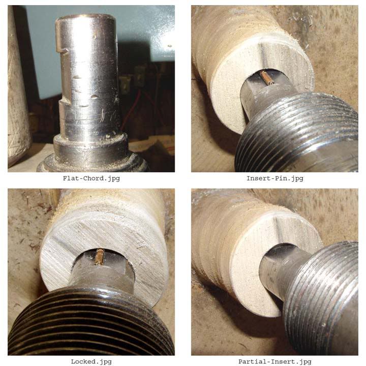

Now regarding the other end. I use a pin chuck to start almost every bowl. Just too easy (and FAR safer than starting on a spur) to start that way, and I don't have to change jaws on the chuck. At $70 I have the most-used chuck in my inventory. Beauty is, the hole is still 1" along the grain, even though it's a sixteenth narrower across. This makes it easy to drop a Forstner down the mortise, at which point I can mount just as it was when green and turn for round. I just need to open the mortise in the bottom a bit to get it perfectly round. Beauty is, it's almost perfectly centered on all but the most outrageously configured wood.
If you have pin jaws for your chuck - Teknatool type which don't chew the wood - you can start smaller stuff on them. If you like that "woodworm" screw, you may use that. Just leave a pillar in for remounting when you rough. After you're circular, you can finish up the bottom before removing the rest of the inside. http://s35.photobucket.com/albums/d160/GoodOnesGone/?action=view&current=BottomHoldProcess.mp4

Mine from bestwoodtools.com http://i35.photobucket.com/albums/d160/GoodOnesGone/Chuck-Sheet.jpg
The only part of the old Masterchuck I would recommend. http://i35.photobucket.com/albums/d160/GoodOnesGone/Old-Chuck.jpg As you can see, two kids worth of turning for tuition took its toll!
