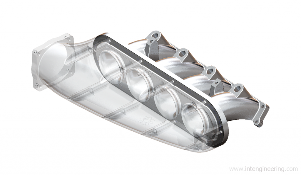

From a physics standpoint, at least as I understand it, the nature of airflow with a bellmouth is pretty optimal. The size of things like the boundry layer, resistances to flow, creation of turbulence, etc. are all fairly optimized with bellmouth inlets/hoods. IIRC elliptical designs are best, including designs with a bit of a curled-over outer edge to the inlet. I wonder if there is something out there that could be used to create a nice, large bellmouth hood for use with a lathe like that. Your bowl is nice and smooth, but the design of it, with the lip pointing at the lathe, is probably limiting the capture potential. If you could find something with that same kind of smooth surface, but where....not sure how to describe it, kind of an inverted shape...instead of curving in towards the hose from a lip at the outer edge that points towards the lathe, you would want a lip that flared away from the lathe, and then curved towards the hose, smoothly. Even more optimally, if the outer lip was actually curved back from the lathe just slightly. That should, at least according to the theory, produce the greatest capture potential for not just things directed right into the area of the inlet, but even things that miss it and fly off out past the rim. It would all be captured, and quite efficiently too.
If PVC is heated it becomes quite flexible. I've expanded and contracted the ends of PVC large pipes to make various things fit. Perhaps it could be shaped to suit nozzle desires.
I'm not sure Raffan's inlet to his dust collector is efficient . I have a vague memory from engineering school about a more funnel like inlet was far better.
The bell-mouth is the most efficient inlet into ducting. It provides the maximum intake of air with the minimum loss.
Turn your own out of wood... ;)
