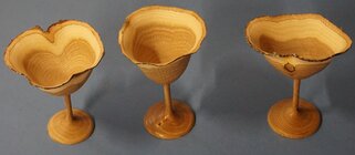

This little goblet is laurel oak - technically a red oak but I think it turns more like white oak IMG_1498.jpeg
