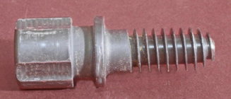

For the life of me I can't figure out what the instructions are describing for mounting the woodworm screw in the chuck. This is a Nova G3 chuck. Are the inner edges of the chuck supposed to fit in the channel under the top collar that is just below the threads? If so, then not all the threads go into the wood. Which of these two pictures show the right configuration.
much thanks from this newbie.
hal
This one so that it won’t pull out
It isn’t intuitive.
People Installing the worm screw improperly is a common occurrence in workshops.
Looks like the shaft is round. Nova used to put flats that needed to face the jaw slides. This keeps it from turning.

Thanks Hackenberry. - wow that was a quick response. I appreciate it.
And now for my followup question - fortunately, that's how I used it for the first time yesterday. But naturally the tops of the jaws prevent the wood from engaging the full length of the screw. Is there something I'm missing in how the wood is attached to this setup?

It shouldnt need the full length, but does need to full seat on the top of the jaws for the greatest stabilty. I generally set the jaws just a little loose then pull the worm screw up so it sits as high as it will go under edge of the jaw then tighten it. This will prevent any loosening from the screw slipping up during turning.

Here is a "cutaway" view showing the proper placement of the Nova screw in a SN2 chuck. The G3 is similar.
Note that the screw has a narrow section which is defuned by two flanges. The narrow section is trapped between the jaws. As Gary said, the screw should be pulled out so the jaws rest on the bottom flange, not the top flange (as in your picture). There are flats on the bottom flange of the screw that mate with the slides of the chuck. You can see from my first picture that in this configuration almost all the threads (and certainly enough) are engaged in the wood.
The shaft that fits inside the jaws has 4 flats, but they're not very sharply cut or easy to see in a photo. If, like me, you use it incorrectly, the screw turns in use and the innards of the chuck machine the shaft round.
Hal, the screw is designed to be installed so that the flats on the fat part of the shaft, the part that goes behind the jaws, are in line with the slides. It's easier to see that they're in line with the pointy part of the jaws, the pointy part of the 4 slices of "pie", which are in line with the slides. The slides stick out just a bit and in theory will hit and squeeze on the flats and keep the screw from rotating during use. I think you can see the flats on the screw in this photo, and definitely the ends of the slides they're supposed to mate with.

If those 4 flats mentioned by Dean are not in the right place there will be a bigger gap in the jaw slices. I always turn slightly a few times to make sure it is held correctly.

No matter what, if your inner voice/eyeball engineer says a procedure is dangerous, then listen to that voice and don't do it.
Just to clarify some points.
When properly installing the Nova worm screw, "pull it out" of the chuck such that the fatter, bottom flange is against the under side of the jaws, keeping the screw from pulling out of the chuck any further when under load. The screw can be installed such that the thinner top flange of the screw rests on the top side of the jaws, but under load this would allow the screw to pull out of the chuck a few millimeters, loosening the hold. This may be easier to see in the pictures I posted previously, but it's important enough to emphasize again here.
The Nova screw requires a pilot hole that is 5/16" (8 mm) and perpendicular to the workpiece. With any screw chuck it is also important that the workpiece sits flat and firmly against the top flats of the chuck jaws. So I wouldn't use any screw chuck on a blank that was not already reasonably flat. I generally use the 50 mm jaws with the Nova.
When properly installed the Nova screw extends 3/4" into the workpiece (I usually make the pilot hole 1" deep). My eyeball engineer says 3/4" is enough, if it's solid wood. Like Dean, I have used the Nova worm screw many times on pieces large and small. I have had no failures of the hold, but that's just my experience.
